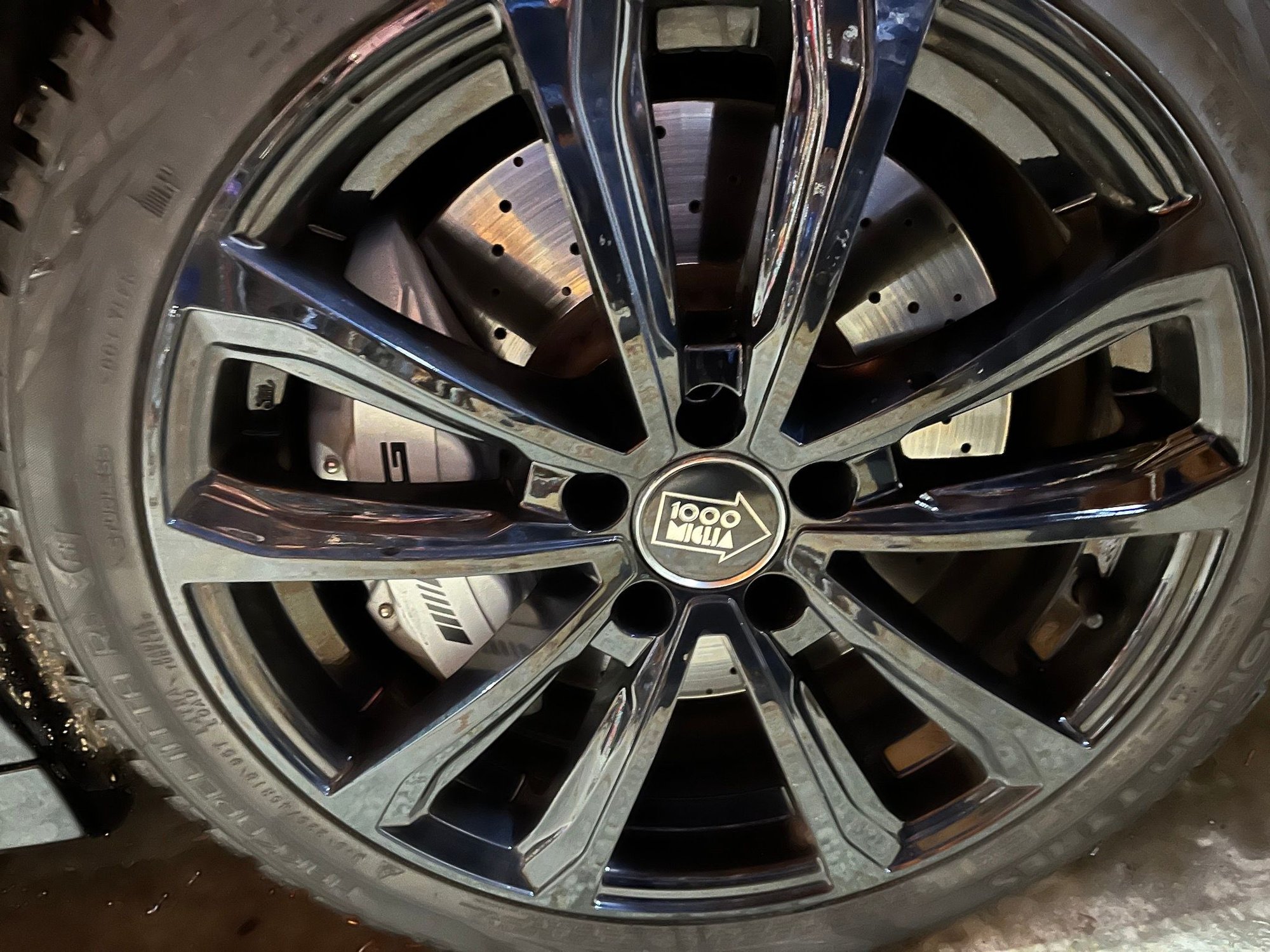

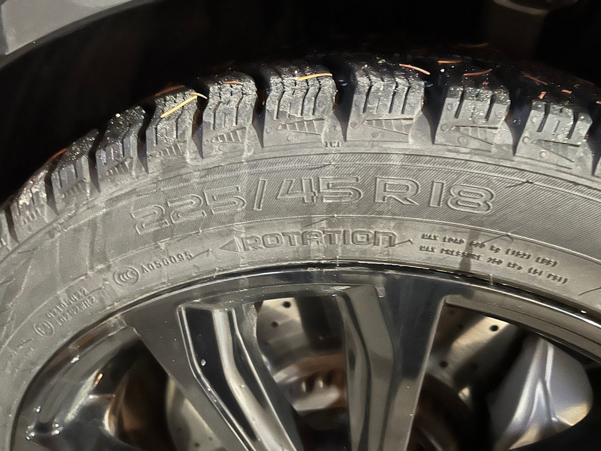

Old Dec 22, 2022 | 03:17 PM
pliukait's Avatar
Joined: Nov 2008
Posts: 86
Likes: 20
From: Ontario, Canada
2021 C43 4Matic Wagon
Originally Posted by Iamlegend0109
So the shop I have the car at just called to tell me that the 18 won't fit over the break on my C43 Coupe. I'm puzzled. Does anyone know if this is just a spacer issue ?
I'm not sure why 18s won't fit on your coupe, maybe coupes are different?
I have a 2021 C43 Wagon with 18in rims, no spacers. Here are some pictures:

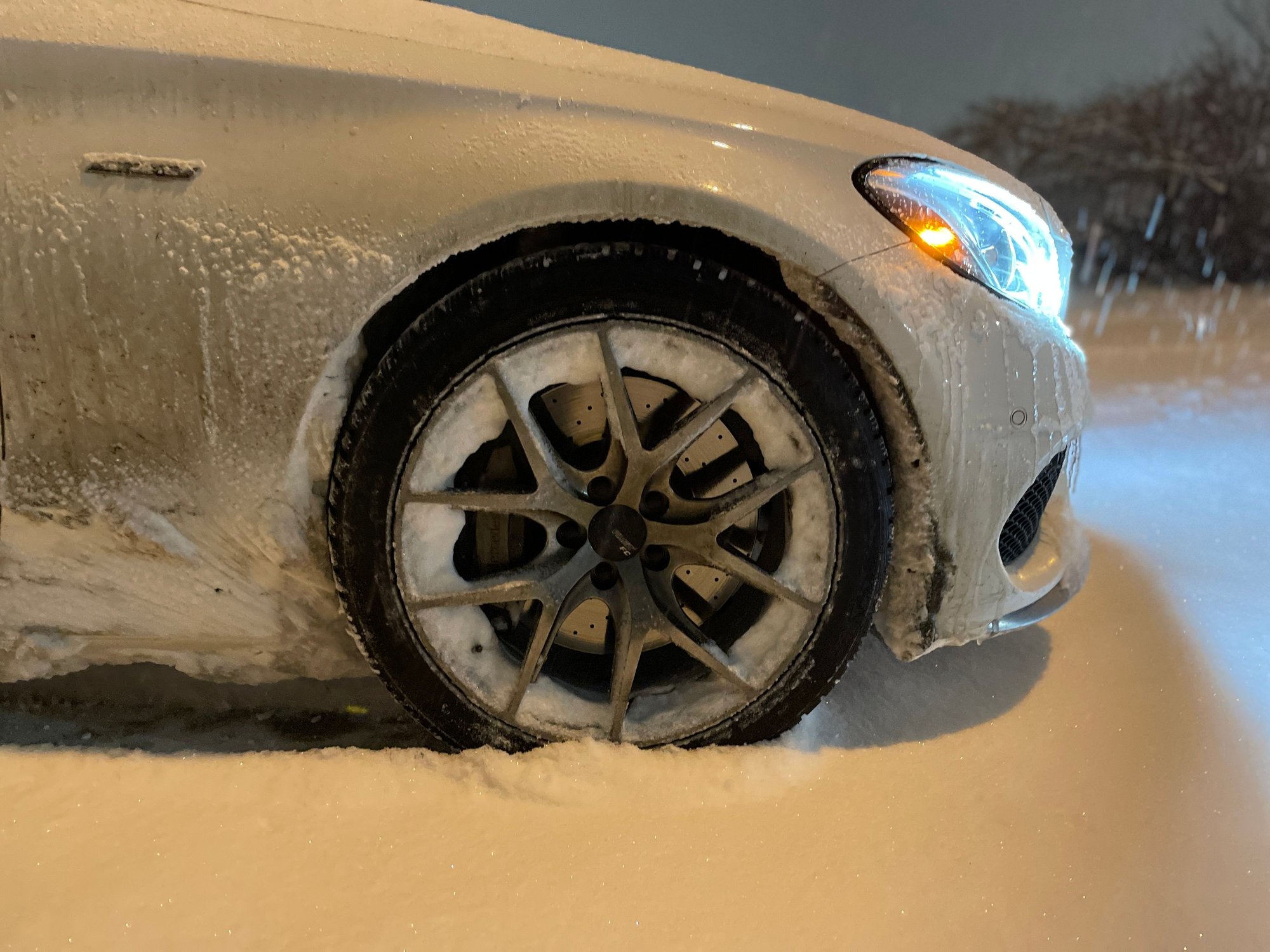

Old Dec 22, 2022 | 06:17 PM
Speed2K's Avatar
Joined: Sep 2007
Posts: 28
C450 AMG
My Nexen’s on Fast Wheels have worked for me so far! 😁 My baby needs a bath really badly though. I think I need some factory style mud guards and side skirts to keep the sides cleaner.
