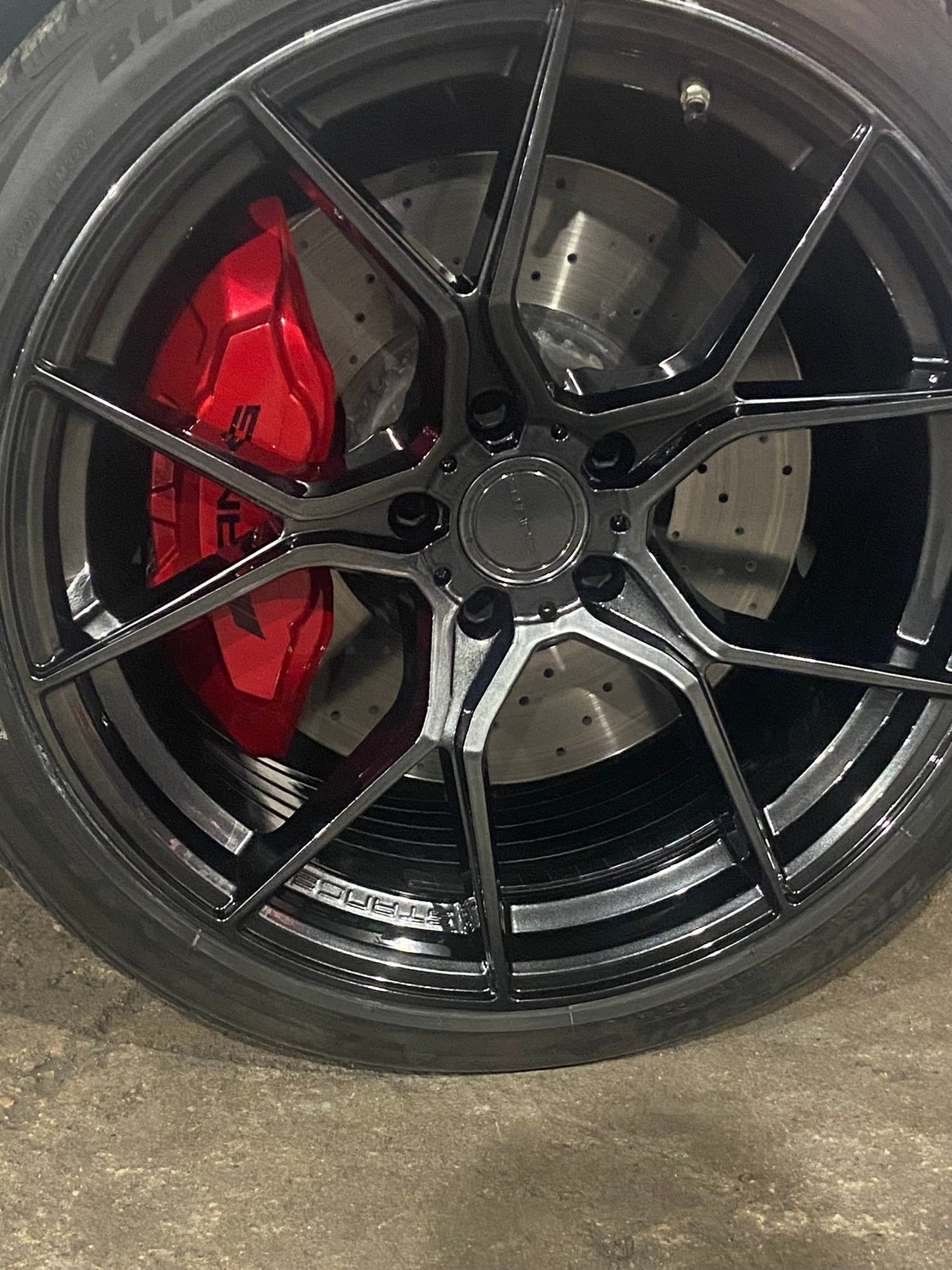

Got the Stance wheels on order and James was quite helpful. Thanks for the advice!

Thanks to Dick Head and Maverick for the advice on the Stance wheels and going through James at Wheel Designers. Quite happy with the look, now I’ve got to clean those calipers up!

Car looks great
those wheels are awesome. Look great with every finish and with every car I’ve seen!!!

U color the calipers yourself ?

No, we’re like that when I bought it used. Just haven’t had a chance to clean them but the paint looks to be in good shape. Would’ve done them in red myself.

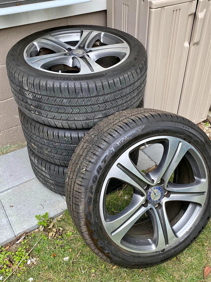

Can anyone identify these wheels?

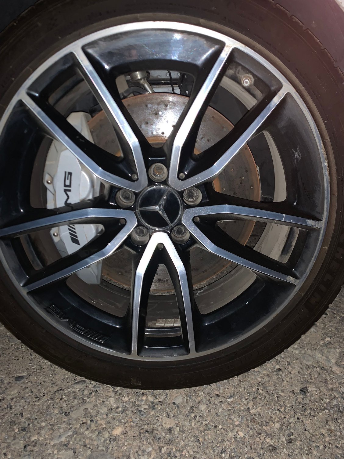

Rims identification
So I have set of rims and I’m not sure if they are original or not ( can’t really tell !) and also the previous owner bought them not me 🙂
Is there any possible way to exactly know if they are original or not??
all engravings and serial numbers seem to be original!!
