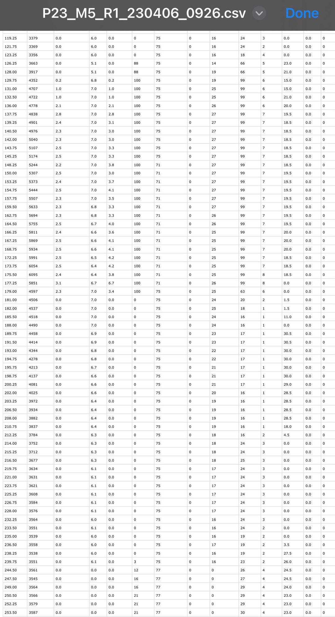

yes I have hopefully you guys can see it
