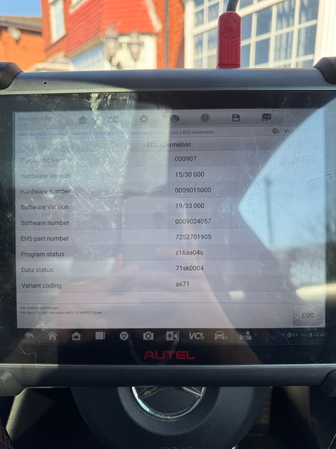

hmm strange my car has full boost and showing the full 360hp on the screen. I just can’t figure out why my pops and bangs have disappeared. That’s the entire reason I fell in love with the car in the first place ! Is there any other advice you can give me on how I can get this back? Attached is a photo of the software my car is running on the tcu would this have a impact on my cars exhaust note sound?
I don't think there's a reason because of the TCU the car to start sounds quieter
Maybe you can bring more clarity, does happen from nothing or you did some updates/service?
