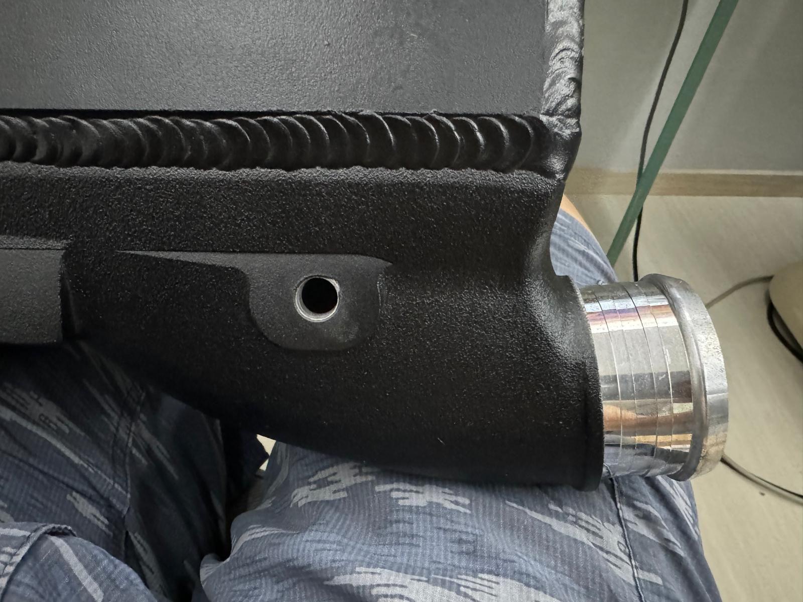

Old Jul 28, 2024 | 11:07 PM
werks400's Avatar
Joined: Apr 2024
Posts: 18
From: Singapore
Mercedes-Benz GLC 43 AMG Coupe
Do check yours, this hole should should be drilled about 10mm deep just for the bracket hole to sign and slot in.
My AliExpress intercooler was drilled through and required welding and re-drilling of the hole; else the boost will leak as the provided bracket does not have O-rings to stop the boost from leaking through this mounting slot.
Hole is drilled through - will leak boost

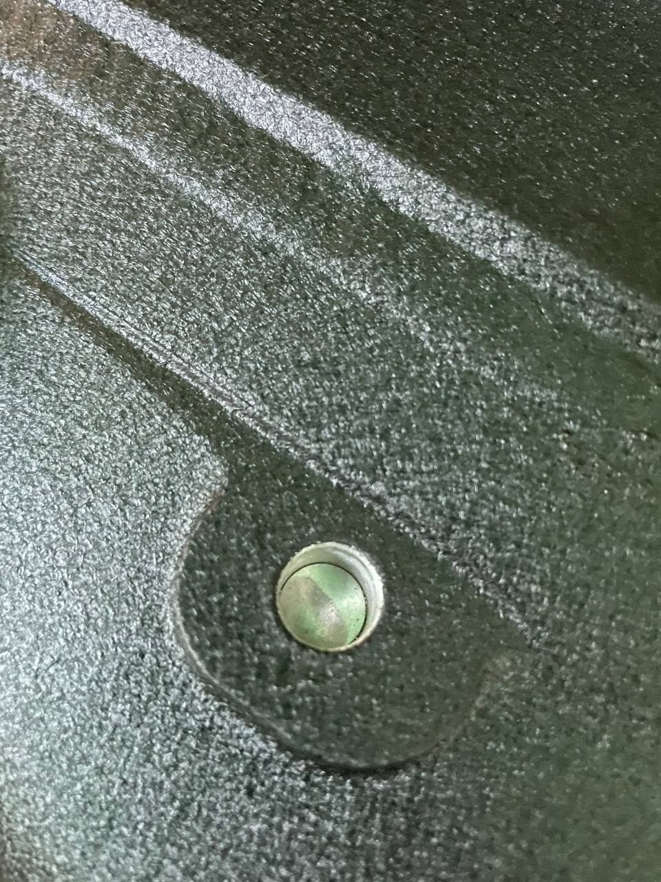

Old Jul 29, 2024 | 09:21 AM
Lou275's Avatar
Joined: Jan 2022
Posts: 73
Likes: 27
2005 CL600 (US model) & 2019 S450 Coupe (EU model)
Just checked mine, not drilled through.
