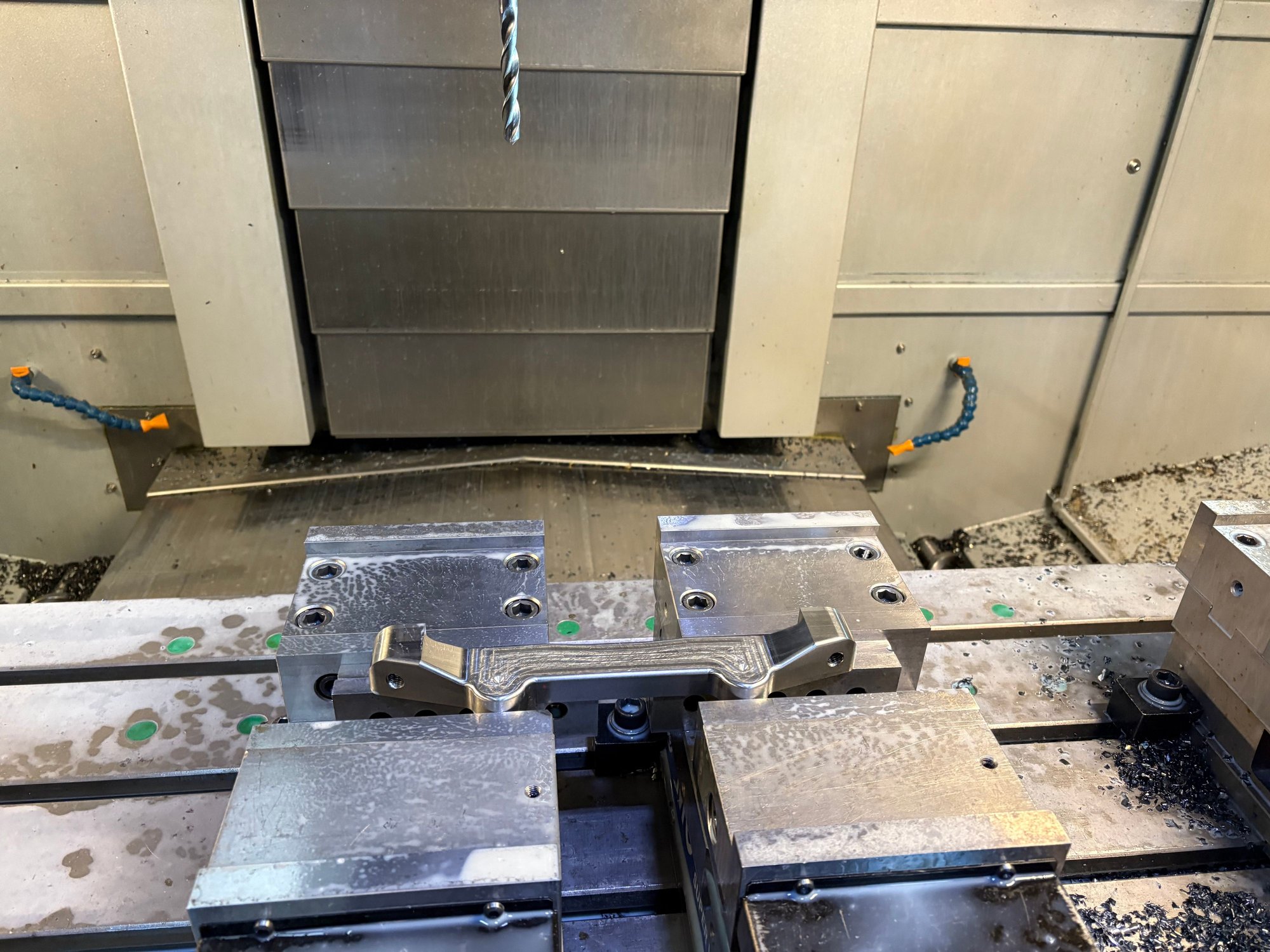

I just thought I would share a new caliper bracket that I have machined for my friends 2017 C43. It allows fitment of a 390mm rotor with 6 or 8 piston calipers.
I can also machine them for 360mm rotors.
I also machine a 19.7661.05 bracket for SL/ E etc.
Theses are made from billet 4140 stronger than stock and far superior to aluminum.
Feel free to contact me if you would like a set.

Have you thought about the engineering specs ... specifically those related to strength of the part?
FYI, the Track Pace app "Highlights" data shows over 3,400 Nm as the peak brake torque when I'm on the track.

I have thought about the strength of the bracket. This is why I will not or ever make them out of aluminum, I have been ask many times. This is why I choose a 4140 steel pre hardened.
4140 comes in annealed or pre hardened.
I have by request made a set of the19.7661.05 bracket for a R230 SL out of titanium, which there are different grades. We choose to make them out of grade 5 titanium for its strength and recommendation by an aerospace engineer friend of mine.
As for destruction testing it would be a good idea to have it done. To have an actual figure on how much torque it can take.
