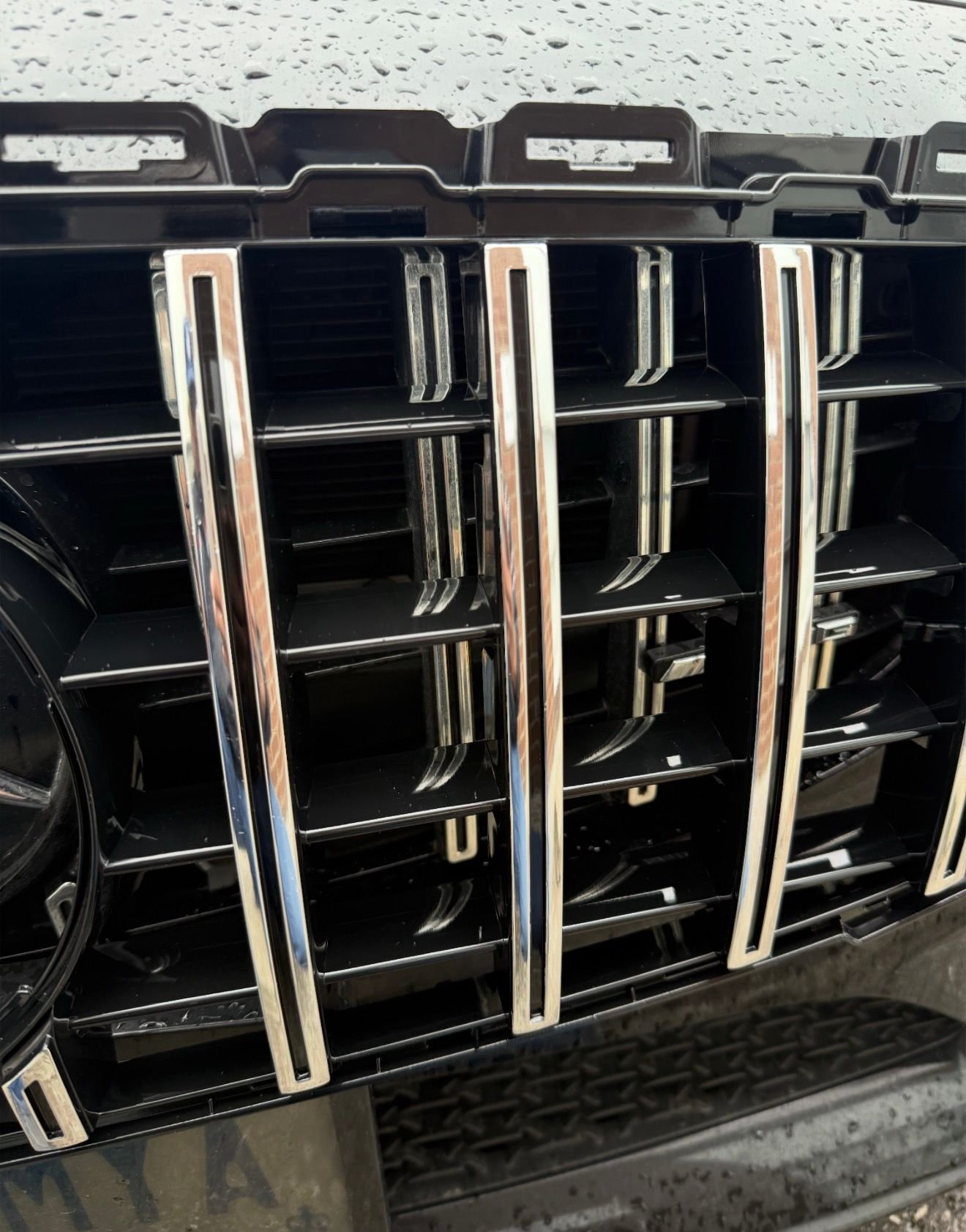

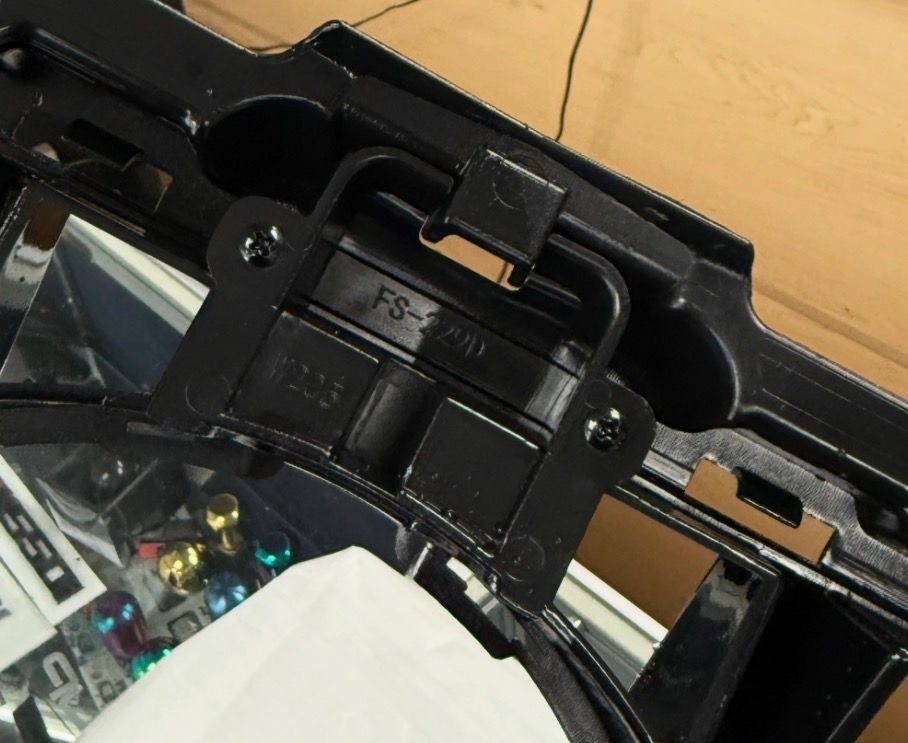

One thing I’ve learned: there are specific design cues to look for. On the back of the grille, you should see “C-cuts” behind the vertical slats—that’s a strong indicator of something closer to OEM quality.

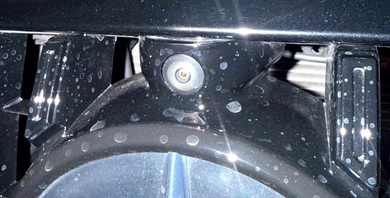

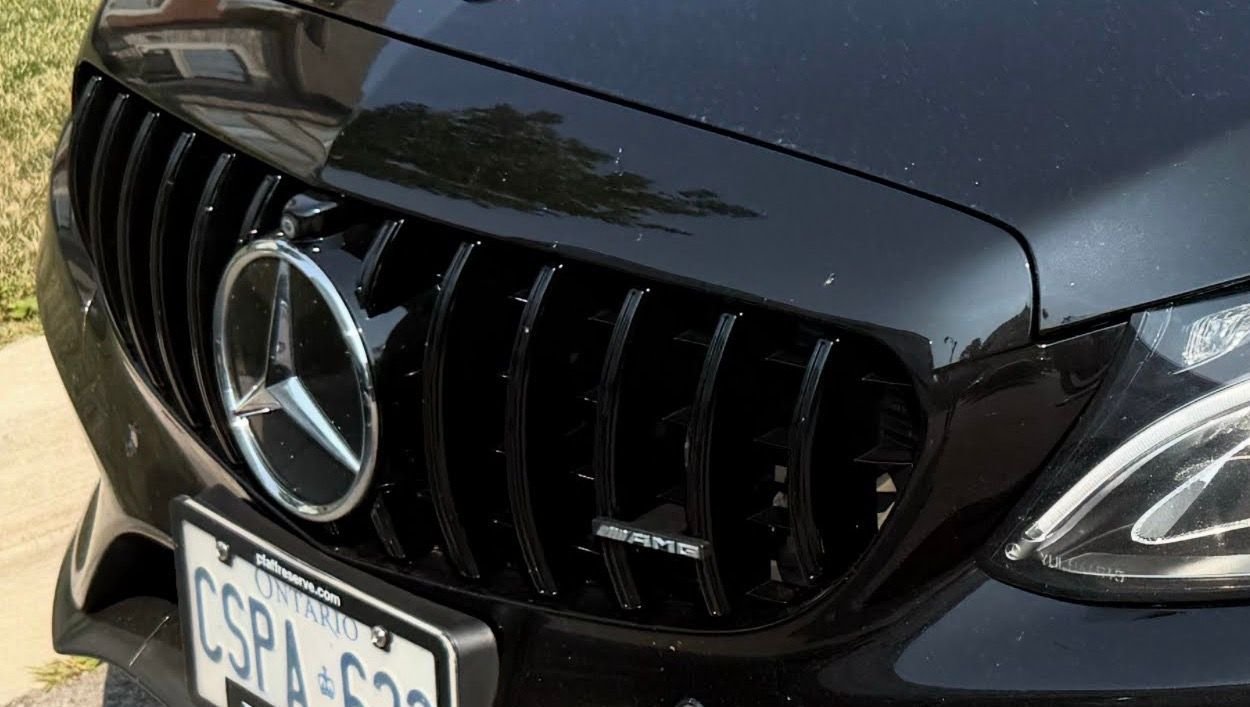

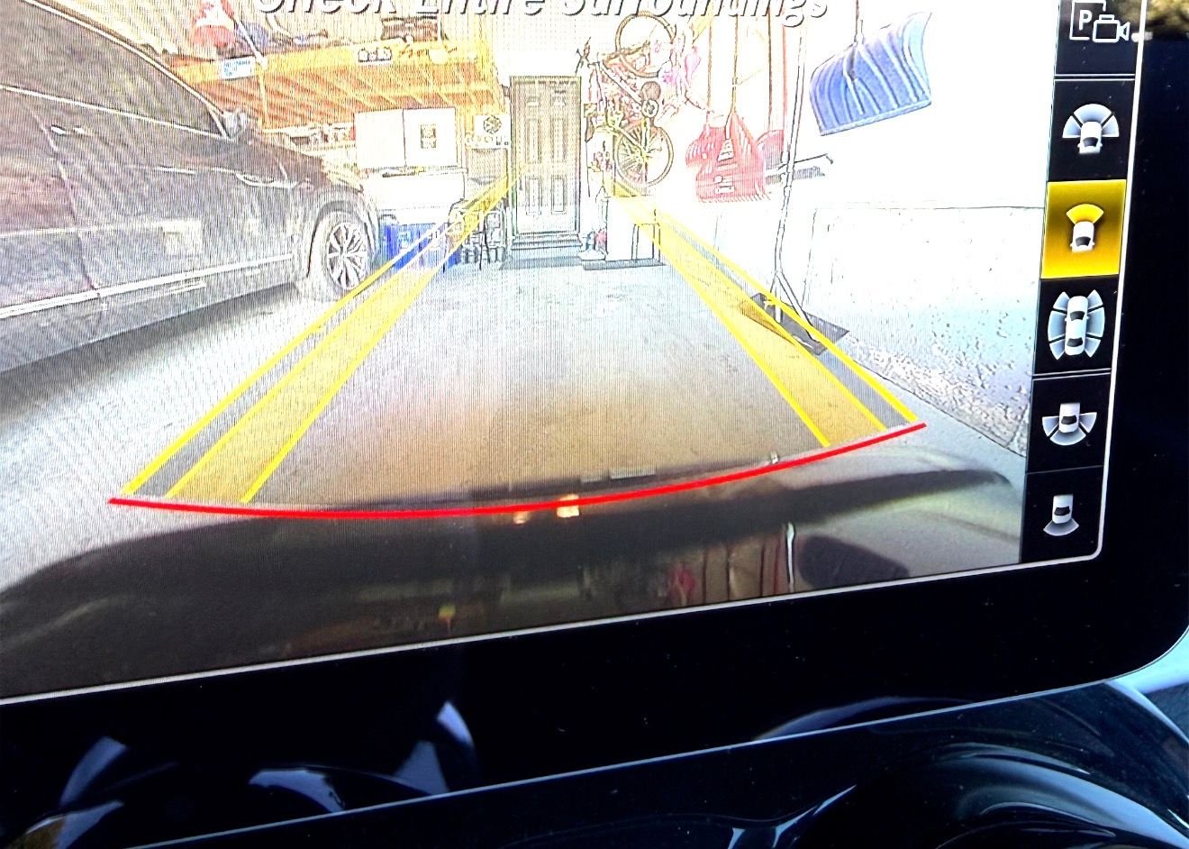

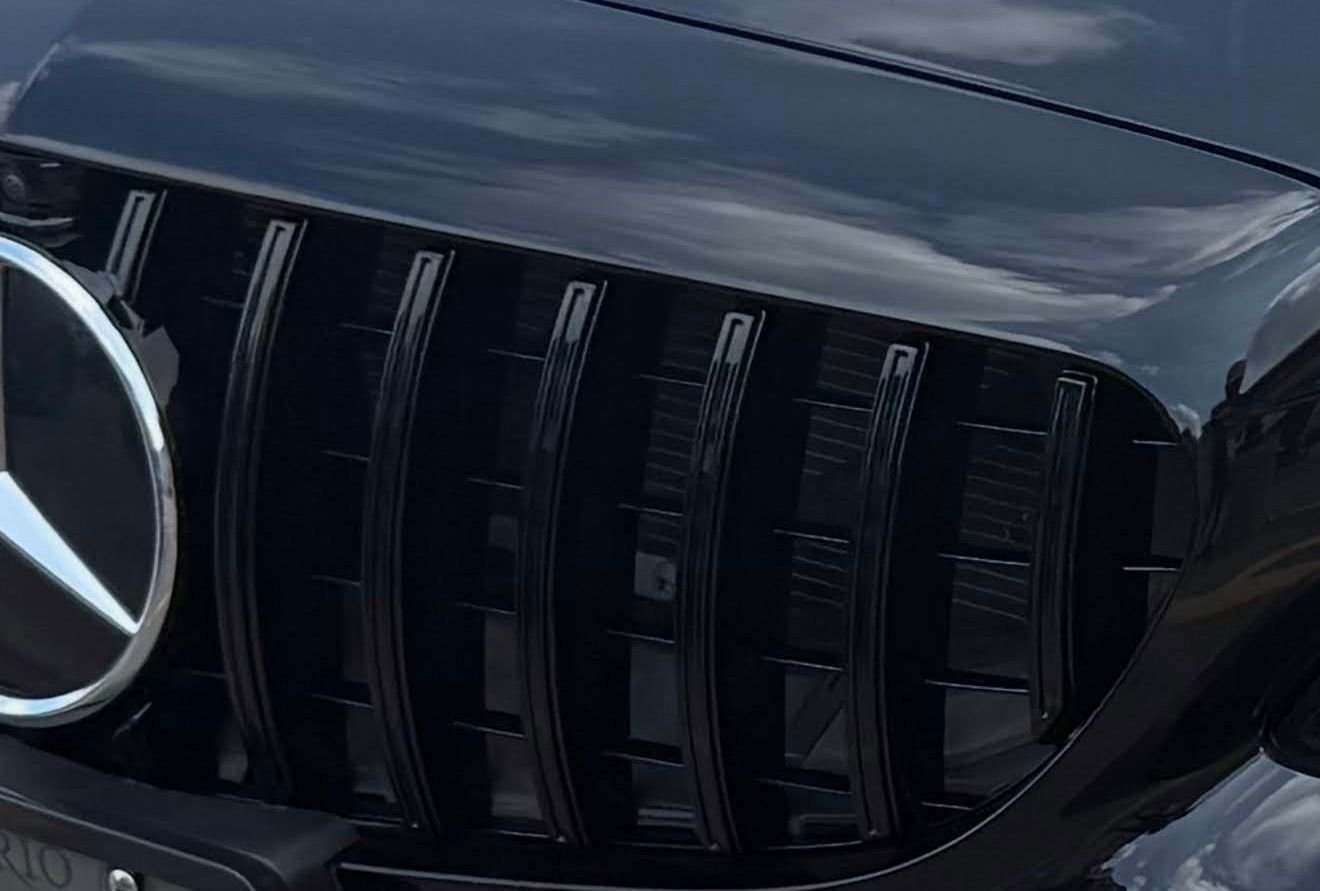

The first shop I went to installed a really poor-quality part. The camera alignment was off, it had six vertical slats coming out from the center emblem (incorrect), and there were no C-cuts at all. It also threw off the 360° camera lines. See below.
See how pushed back the camera molding is

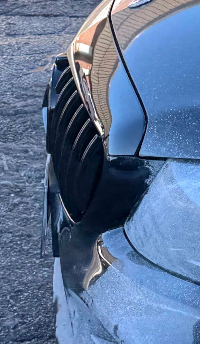

Then I noticed the same shop installing different grilles on other cars, where the vertical bars extended much further outward and the camera sat noticeably more forward. From what I could tell, those setups were likely for pre-facelift models.

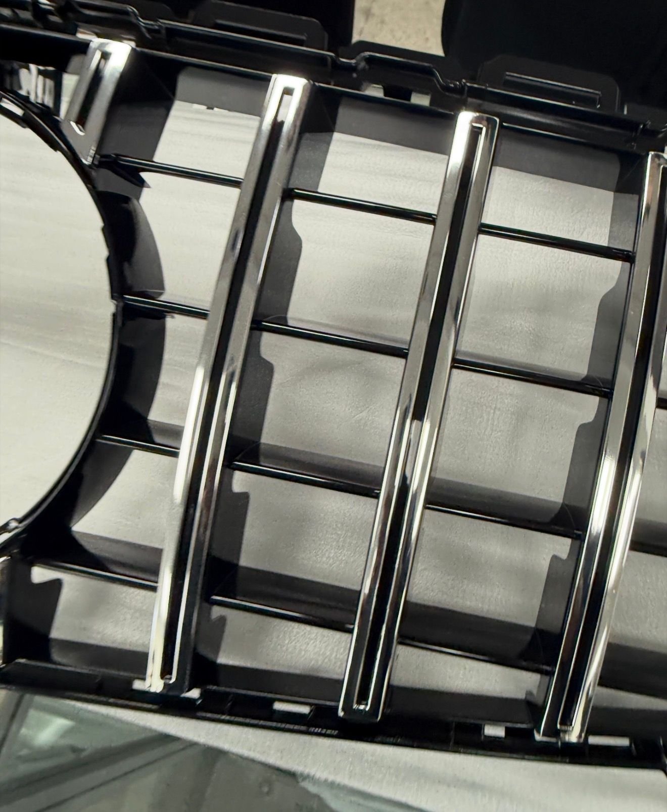

After doing more research, I came across MBHouse—they confirmed the 360° camera would function properly and that their grille includes the correct C-cut design, however look at the vertical lines …
Here’s what I’m running now—and to be fair, everything works properly. But if you look closely, the horizontal slats (the black ones, not the chrome) aren’t as thick or wide as OEM.

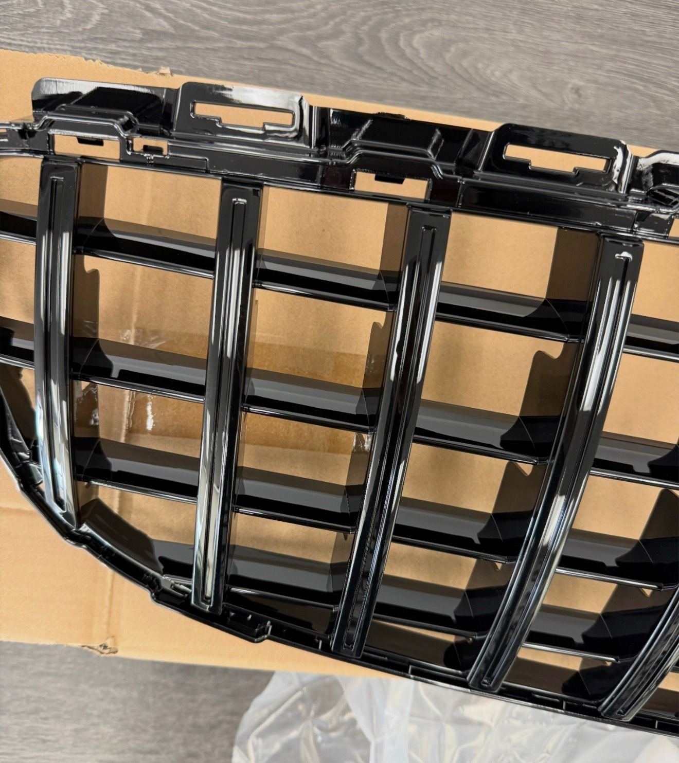

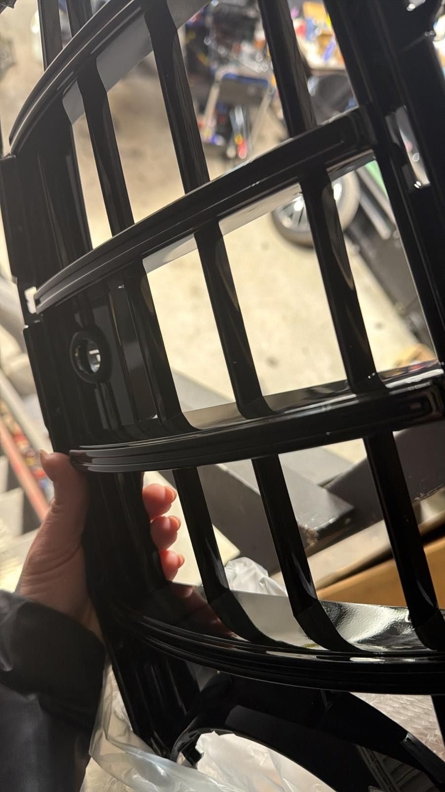

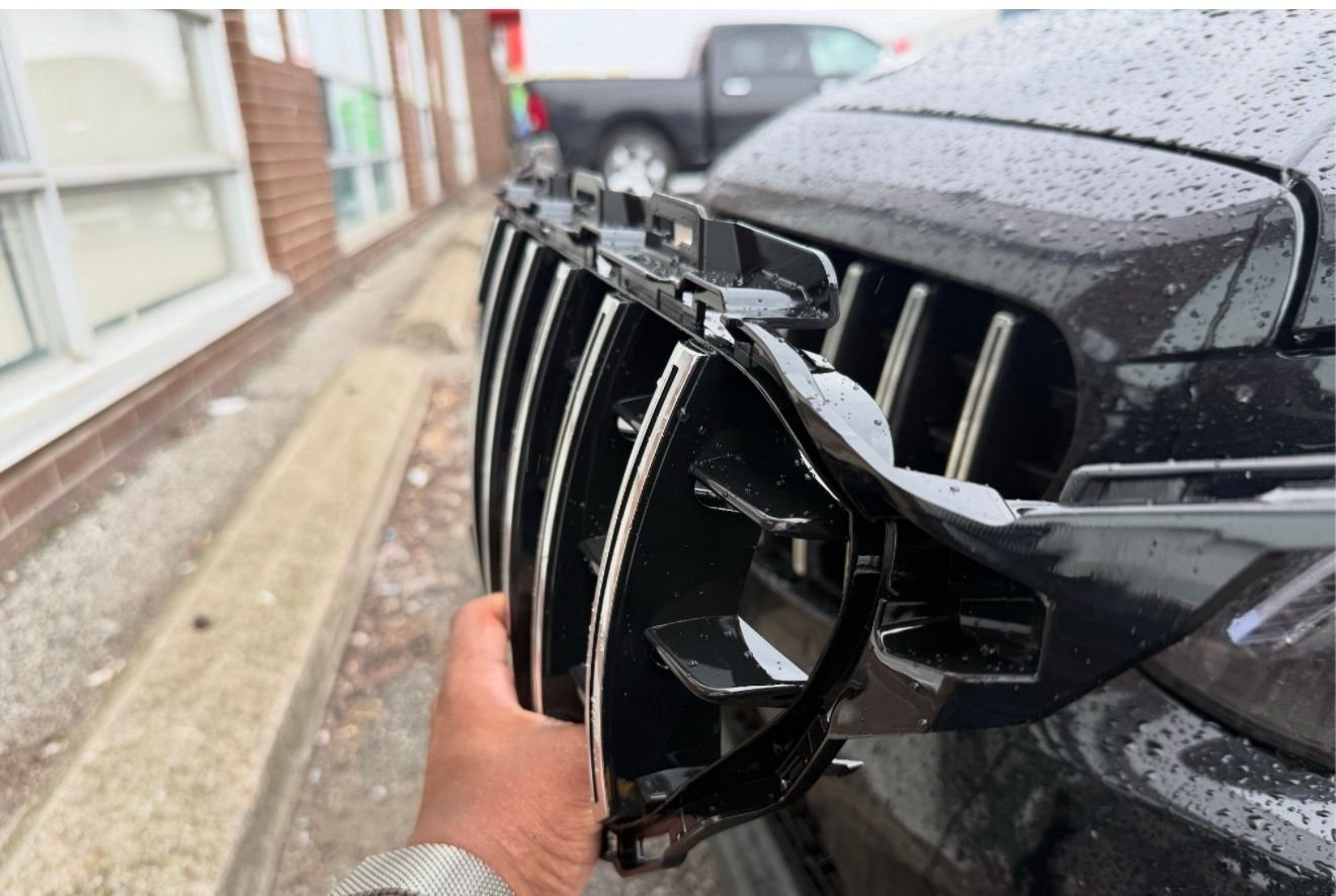

After digging further, I found another set of grilles that seem much closer to OEM spec. They have the proper C-cuts on the back, noticeably wider/thicker horizontal slats, and slightly thicker vertical bars as well. My only concern is whether switching to this style might impact the 360° camera functionality.
Visually, I do prefer the wider horizontal lines—it actually makes a big difference when you’re looking at the car head-on.
Has anyone run into this before or know exactly what I’m referring to?
I’ve included angles of both grilles so you can compare how far they protrude and the thickness of the vertical and horizontal elements. You’ll also notice the newer grille looks a bit more “boxy” in the vertical slats compared to the one I currently have.
The part number on this recent one I found
