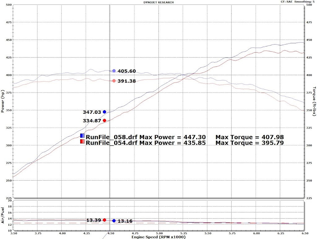

Based on the chart you have losses in HP and torque up to 5300 rpm , or so, and gains there after. Seems to me the losses are in the range you would normally, every day type driving, want the additional power. Just by eyeballing the curves the resultant differential area under the curves would leave you with a net overall loss. Not trying to be all negative, just what I see based on the info provided. Guess would be a good senerio for a car being drag raced but not so much for a daily driver. Just my opinion, remember how much you paid for it, that's what it's worth.

2009 C63
What graph are you looking at? ^^

Those curves don't crossover at 5300rpm, they just happen to meet at that point in the graph.

Just comparing the dyno results for before and after torque and HP. The individual posted gains at one point, max recorded RPM, don't quantify overall performance. I might consider what type of result I was looking for based on the type of driving anticipated, etc. Overall performance can be thought of as the area under these curves and the difference between the before and after areas woud be the net loss or gain, as the case might be. Looks, in this case, you get either a bit more torque or HP but at the cost to the other. So, this information is informative and provides insight as to actual performance and wether it meet your individual needs. Entirely dependant on what those needs might be.

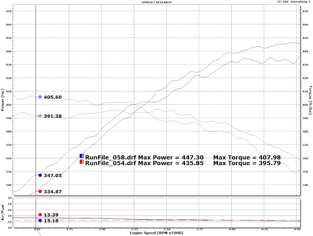

Raygt3, you are not reading the dyno graph right. There is never a loss.
The blue line (top) is the after pull. The red line (bottom) is the before pull.

even closer look . . .

Sorry, my apologies. Looked on my monitor, on the origonal post, as though the curves crossed over. Again sorry.
