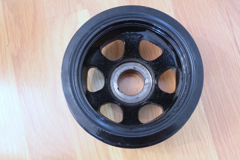

The quality is certainly top notch. A new belt and modified crank bolt is included along with very detailed instructions (photo below). Once evosport was back in stock, the pulley arrived at my door in 3-days. Packaging was excellent.
Install:
I had my local shop (CarbConn in Kirkland, WA) do the install. It's about a 2 hour job. It went very smoothly but there were a couple unique things to call out.
1) They needed to lock the transmission flexplate to remove the crank bolt as they didn't have the OEM pulley counterholder tool (MBZ Essential Service tool (EST) #112589004000). Same procedure was followed when they torqued down the new bolt.
2) Instructions also called for heating up the evosport hub to 200-degrees before installing it onto the crank. CarbConn had a little convection oven on site as they've dealt with this requirement during previous pulley installs. Using a torch is another option, but the oven heats things much more uniformly. It went on like butter once it was heated up. Welding gloves are a must.

evosport Power Pulley Kit
OEM Pulley
OEM Pulley Installed
Time to cook the hub!
Hub installed.
evosport Pulley installed.
