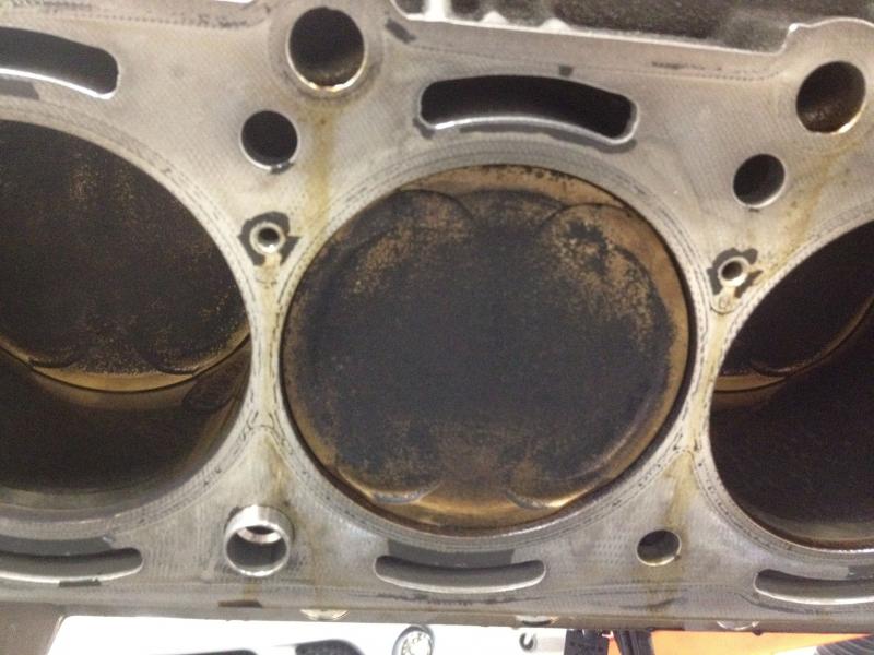

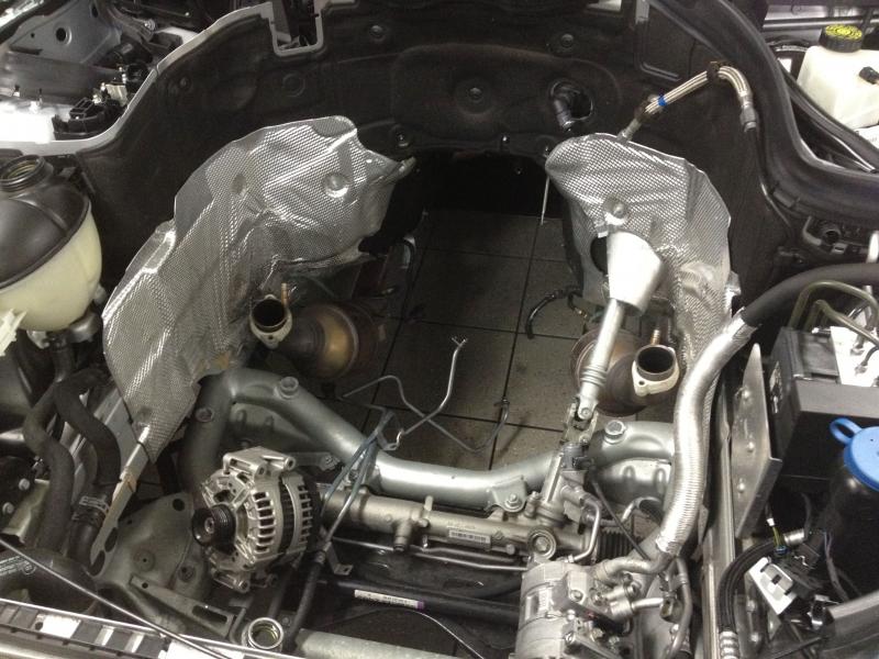

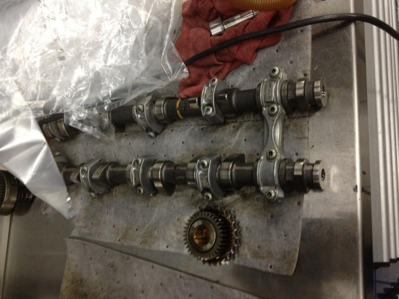

Here are some quick photos from my iphone...
Attached Thumbnails Oil Consumption Question-photo-feb-28-8-48-13-am.jpg   Oil Consumption Question-photo-feb-28-8-48-17-am.jpg   Oil Consumption Question-photo-feb-28-8-48-33-am.jpg   Oil Consumption Question-photo-feb-28-8-49-05-am.jpg   Oil Consumption Question-photo-feb-28-8-48-56-am.jpg

How did the cylinders look in person? Was there any cross hatching visible?
I can't see much from the picture...
Have you talked to the techs about the repair, break in, etc?

So to the untrained eye they looked and felt really smooth. As far as break in he said they would do the initial testing then I should as you said drive the crap out it to help the seals get seated.
