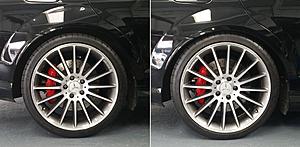

Just lowered MY09 with PP on H&R springs.
I also have Michelin PSS:
Front - 245/35/19 (12mm Spacer)
Rear - 265/30/19 (10mm Spacer)
Only rubs on really harsh bumps.
