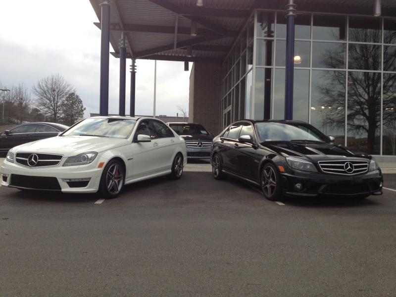

Yes
Left is 2012 P31, right is 2009 P30, if it helps.
