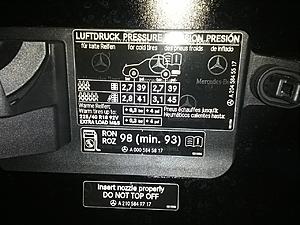

my passenger door sticker only has one set of numbers
F 41
R 45
the gas flap says
low load 39/39
full load 41/45
but it looks like this is for 225/45/18 all around M&S winter tires?
it says when warm +4 psi F & R
I'm running tires that have a higher load rating
when reading the oem pressure/load from a load/inflation chart I get 39/41 for my tires when I equate the oem load to my rating...that is what I run
seem to be wearing very evenly, did a chalk test

My flap says 41/41 but the TPM thinks 39/39.
I set the cold tires with an accurate gauge to 41 all around and recalibrated the TPM. It read 39/39. Very annoying. I had to drop the pressures to 39, reset the TPM and then bump them to 41. Not a big deal but stuff like that irritates me.

Attached Thumbnails Correct Tire Pressure-ds_door_jam_tire_psi.jpg   Correct Tire Pressure-gas_flap_tire_psi.jpg

Two different questions here: 1) What is the correct tire pressure for street? 2) What is the correct tire pressure for track?
1. While the label on the driver's door jamb shows 41/45 front/rear, the fuel filler door label shows that this is for 5 people and luggage. Under normal conditions, the figures are 39/39 front/rear.
2. At the track, you must have a tire pyrometer to properly set tire pressures. The trick is to drive the car then quickly check the temperature of each tire (use the stick-in probe, not the IR laser) at the outside edge, middle, and inside edge. Average the outside and inside edge temperatures; if the middle temp is lower, then the tire is under inflated. If the middle temp is higher, then the tire is over inflated.
This is the ONLY way to correctly set the tire temperature at the track. Frankly, this is how to also do it under normal road conditions, too, regardless of what the fuel filler door says. Clearly, the idea is to have ALL the tire contact patch working equally, which means that temperatures are even across the fact of the tire. If the middle of the tire is working too hard, grip is compromised (since the edges aren't working hard enough). BTW I'm a mechanical engineer and instruct for the Porsche and Mercedes clubs
You'll notice that often the inside and outside edges of the tires have different temperatures. If the inside is running hotter than the outside, then you have too much negative camber and you need to dial it out. If the outside is hotter, then there's not enough caster and in corners the tire is rolling over. Good luck on this, though, as I don't believe camber is adjustable on the W204.
