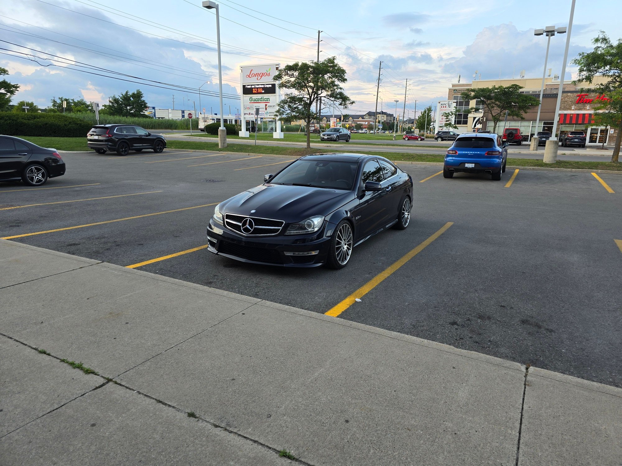

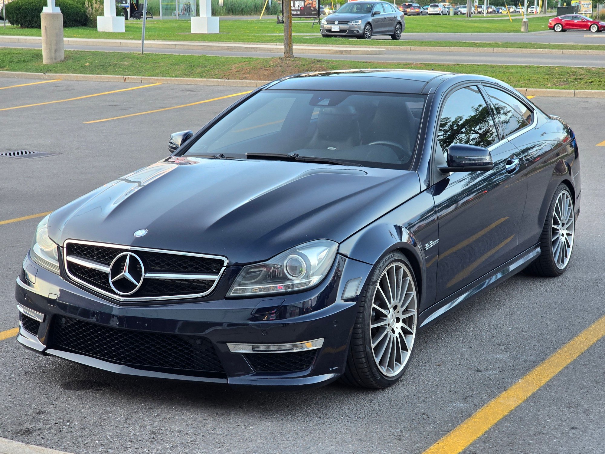

Old Sep 9, 2024 | 12:03 PM
  #291
Drifter2090's Avatar
Joined: May 2018
Posts: 98
Likes: 18
From: Ontario, Canada
CLS63 AMG, E92 M3
Here's my 2012 Coupe on H&R springs, stock 19" tire sizing, 15mmF and 12mmR spacers.
Rear does sit higher than I'd like, maybe ill try removing a spring pad or going to a smaller one.
Debating switching to an aftermarket 18" wheel for more comfort as it's my daily.
*ignore the red tape, has my windshield replaced
