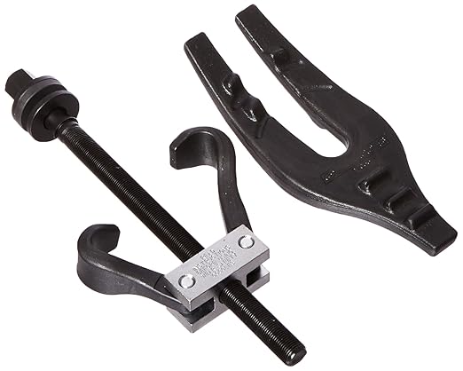

I'm able to adjust my KW DDCs without removing the spring. Insert spring compressors up through the center of the coil, compress, then adjust the collar. It requires a slight disassembly of the spring compressors, but is easy enough.

Thanks for the tip, I'll have to give it a try. What type compressor do you use? Clamps/hooks or the discs?

I rented a set like this from O'Reilly. You have to remove one arm, by knocking out the pin, and reassemble once its inside the coil (then repeat the disassembly to get them back out). Takes about 10 minutes to do each side.
Note: This picture from amazon has the arms installed upside down.

Thanks Tpete, I'm going to give this a try!
