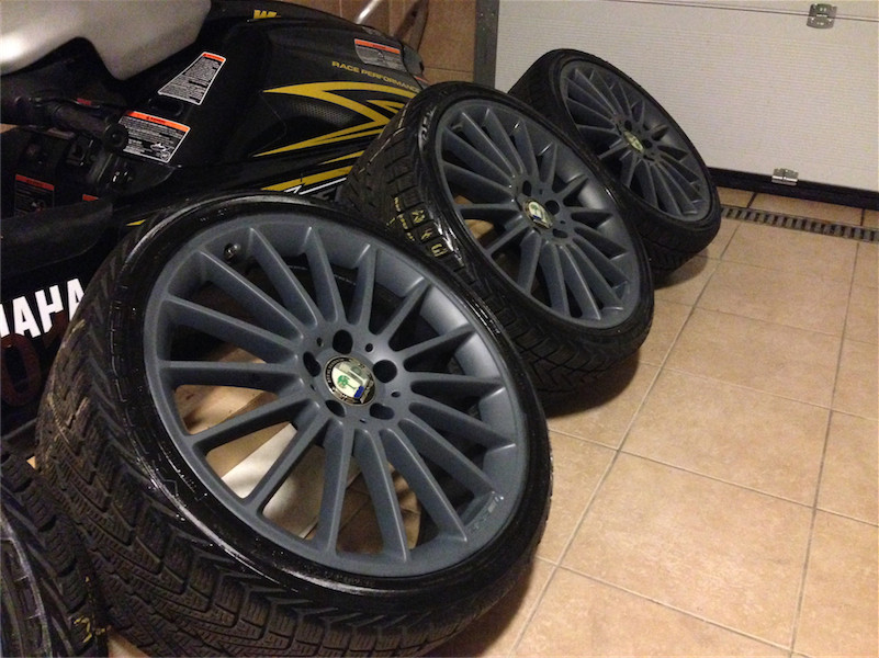

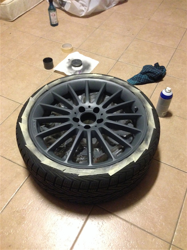

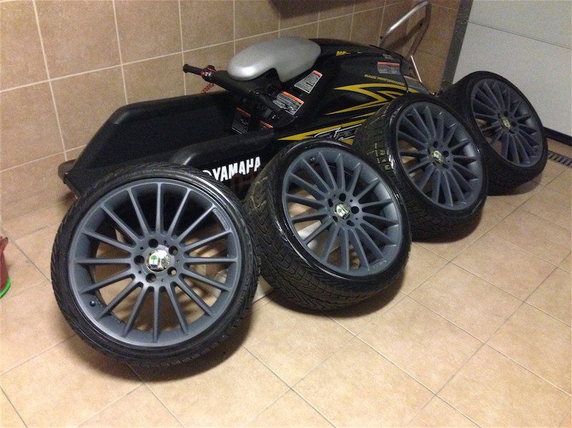

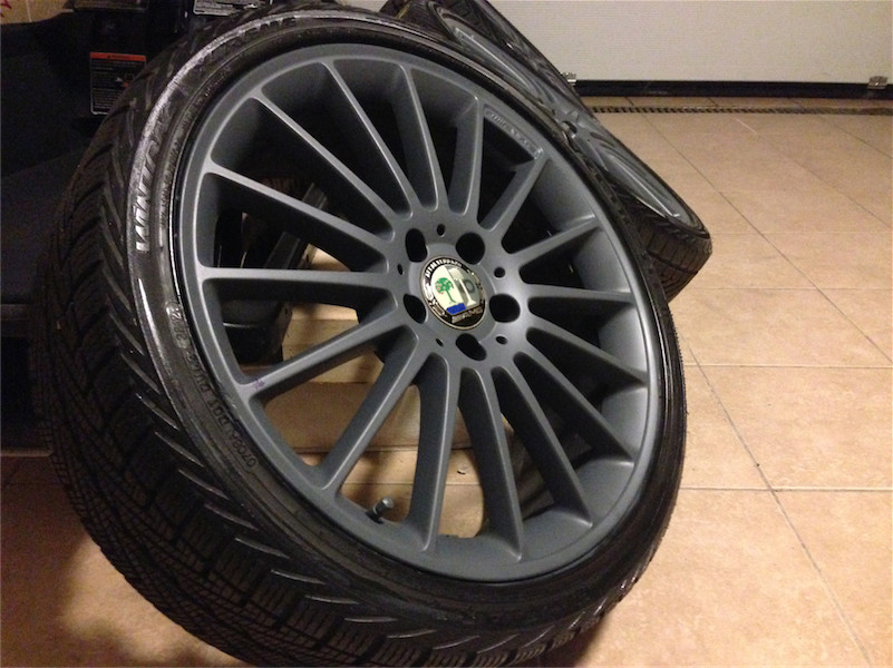

Winter is coming… And being too busy I haven't had the time to re-powdercoat my multispokes.
I decided to try something new (for me) - PlastiDip in Gunmetal Grey.
To say the least I am really surprised to see how good the wheels turned out.
I haven't expected such a nice texture, color, and look.
I'll be mounting these tomorrow or on Saturday so I'll post a few pics.

Originally Posted by abcut973
Not bad at all!
Where did you find this color? online?
It's a basic PlastiDip color - gunmetal gray. You can get it online at every PlastiDip reseller.
They say you can use a metalizer on top to give it a shine but I like the primer look.
Old Nov 14, 2013 | 06:33 PM
  #158
Faris63's Avatar
Joined: Nov 2009
Posts: 1,073
From: UAE
'13 CLS63 PP
Looks really nice Matt
Have you tried making wet coats to prevent texture ?
Old Nov 14, 2013 | 06:36 PM
  #159
olszowa12's Avatar
Joined: Feb 2010
Posts: 4,650
Likes: 74
From: Gdynia, Poland
'08 C63 Estate
Thanks Faris. It was my first try with PlastiDip.
I did it as the guys at DipYourCar.com instruct on youtube.
5 coats, 15 minutes, between each coat.
The sides of the spokes required more coats than the face of the wheel.
I didn't do wet coats. I waited each time for the previous coat to dry off.

Originally Posted by noodleman
how many cans did you use to do this?
looks cool!
I bought two cans but used only 1/4 of the second can.
Thanks noodle

The winter wheels are on but I'm not sure it turned out the way I wanted it to …
When I mounted the wheels today and drove the car out of the garage and looked at the wheels I was extremely surprised - they are blue-grey and not gunmetal-grey
I'll post some pics tomorrow.
