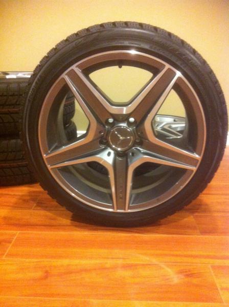

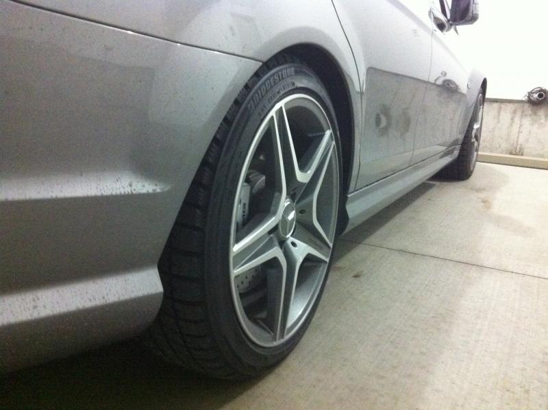

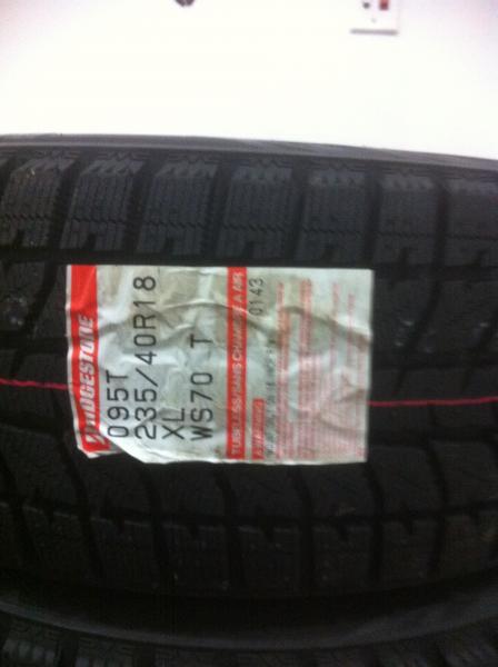

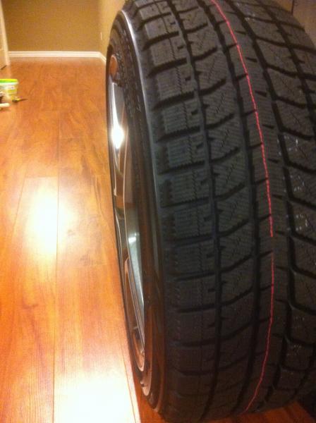

235/40/18 blizzak WS70 on 18x8 OEM
Best sizes for snow tires?-photo-4.jpgBest sizes for snow tires?-2012-12-15-14.53.25.jpg
