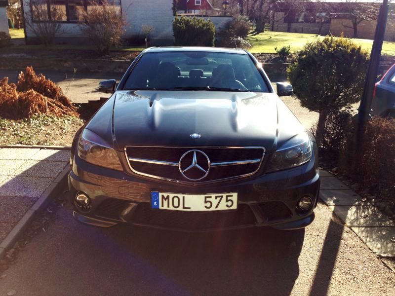

It is possible to make the FL grill fit, I did it already
Only issues are two little gaps at both corners of the grill.
This is how it looks like:
Here is my discription how to install it
Originally Posted by Dome's post from the C63 picture-thread
I didn't make pics of it.
But when you clip out the pre FL grill and try to clip in the new one, you will see that the clips of the bumper don't match.
You have to enlarge 3 of the 6 slots at the bottom of the new grill (the outer left and right slot to the inside, the left middle slot to the outside).
After that you can pull the FL grill over the pre FL bumper

Done the same as Dome :-)
