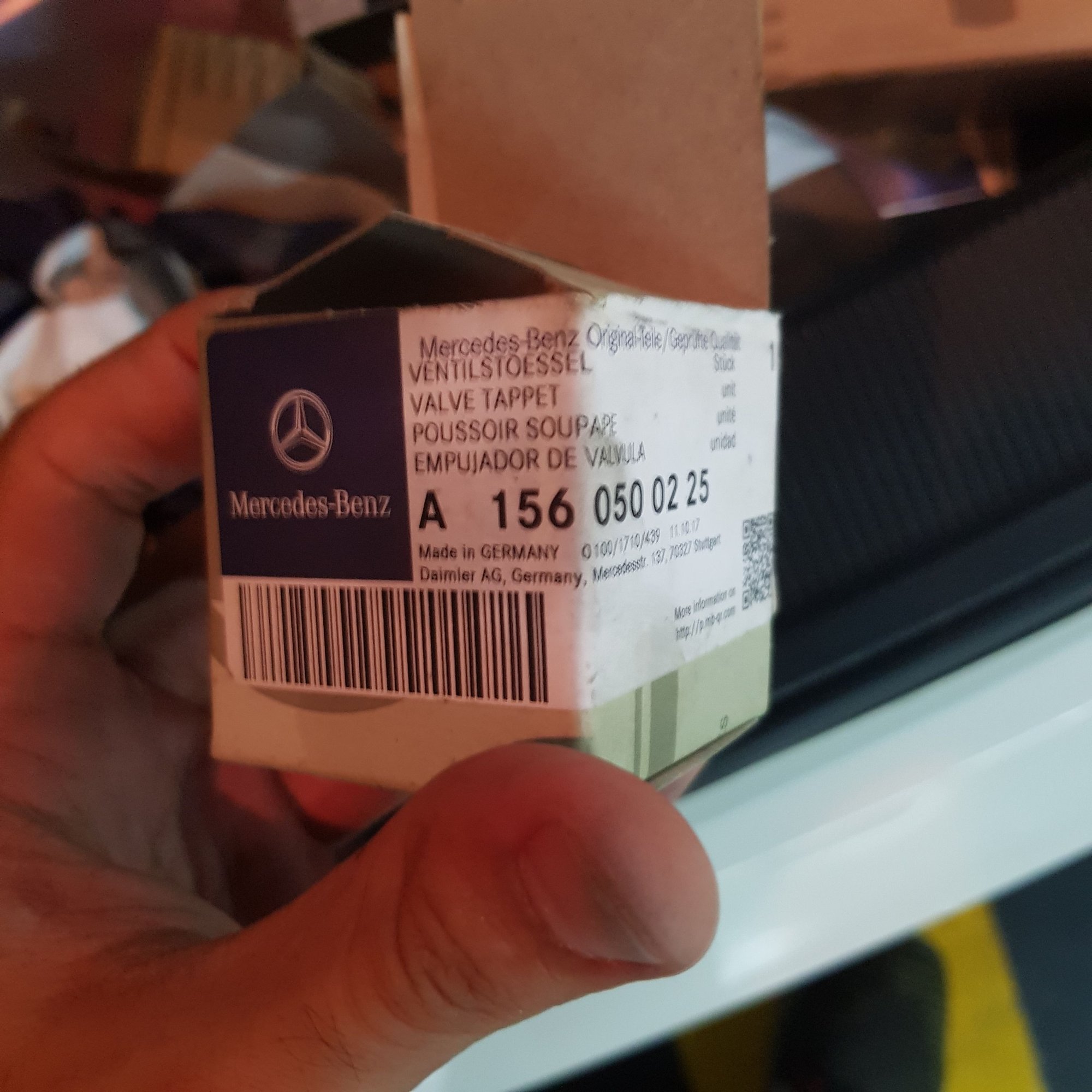

Guys I live in UAE and I own c63 507 edition I had the engine ticking noise problem that disappeared when the car gets warm like 3 minutes after running. Even if sound dissapeared after 3 minutes it wasnt normal. I took it to Mercedes dealership here and after 10 days of investigating they confirmed that it was one of the valve tappet and they replaced all 8 under warranty and car is perfect. Hope this helps
Please note the noise usually comes up when I dont drive the car for 4 days or more but now it's all sorted and even if I dont drive it for 14 days no noise appears
Valve tappet

The noise could be due to malfunction in one of the valves .. as the valves open and close it would adjust it position after few minutes hence the noise disappears. If car is under warranty ask them to replace the valve tappet. The labour cost is high as they need to open the cylinder cover in the engine
