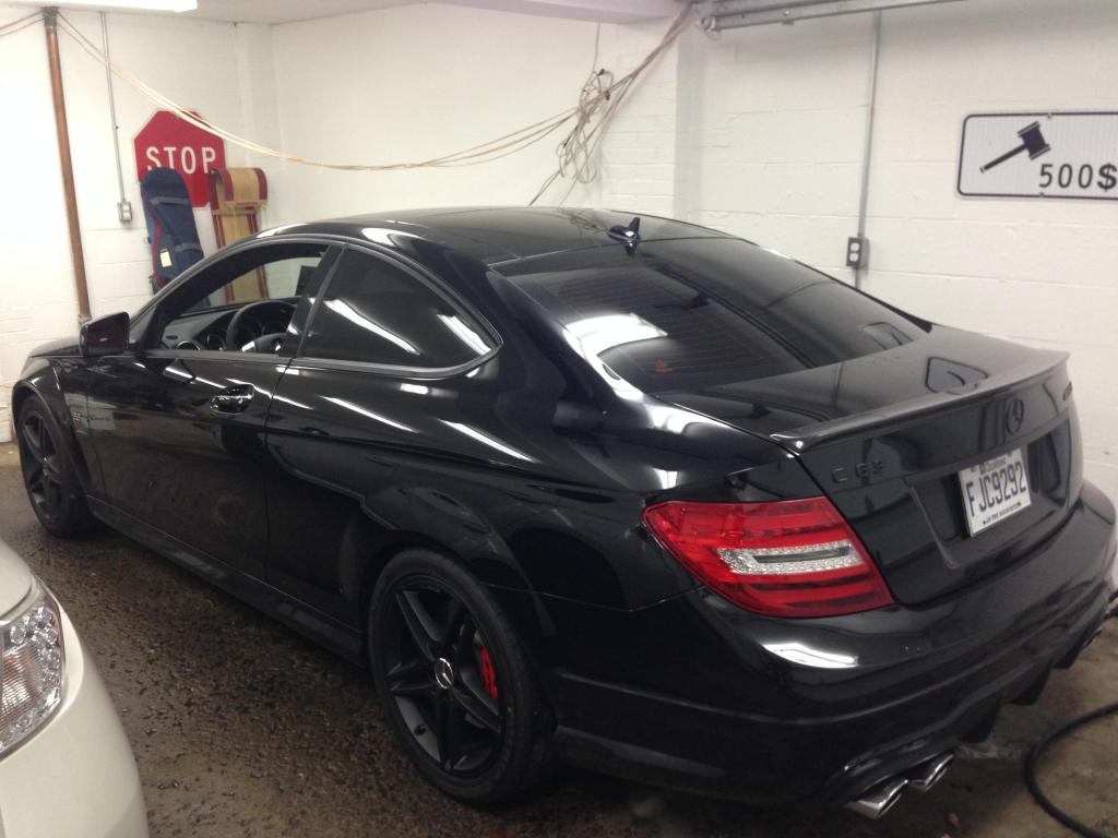

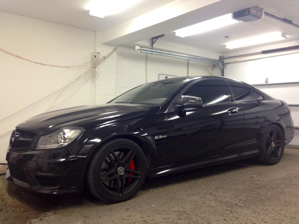

I put on 275 35 18 in the rear, looks great and I get much better traction now.

Originally Posted by raz3091
Do you have a pic of what that looks like?
Might not be the best pics, 275-35-18 in the rear. fronts are stock 235-40-18, going to go with 245-40-18 next summer
