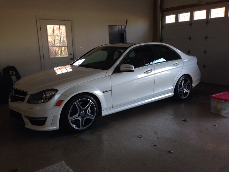

The DC weather has been horrible for the last couple of days
