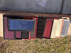

Tried all of them. From my logging device seems like the aFe pro R let most air in. And they are oiled ones. http://afepower.com/shop/details_new...amg&brandID=59 Pipercross air filters. Has anyone seen this before?-c6f27b1a-78cd-4244-8f94-4785bcd08f87-1265-00000186b66bf2ac.jpg
