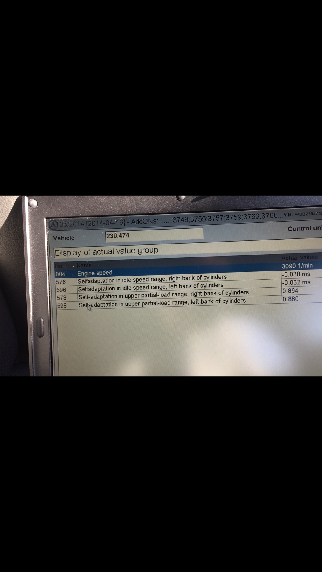

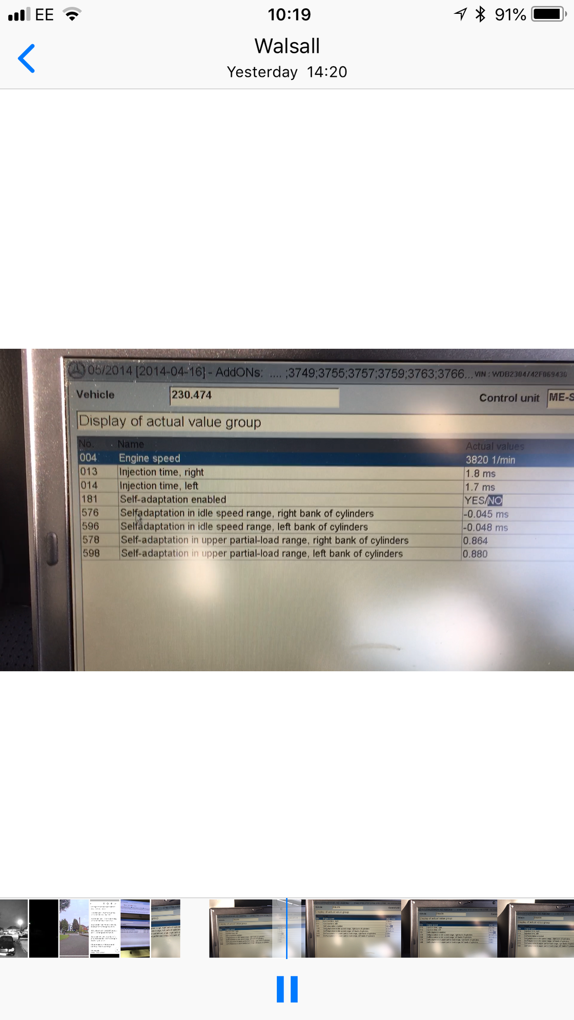

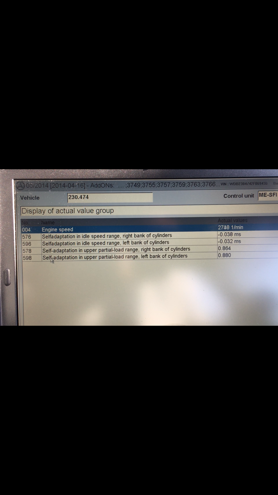

SL55AMG FUEL TRIM - STAR DAS READINGS HELP
Hi
I know this is a old thread, but I have an momentarily power loss (Jerk) on my Mercedes Sl55 AMG R230, almost like the fuel pressure is lost for a millisecond, this is intermittent.
I have educated my self some what about fuel trims in % against rpm. I have access to STAR XENTRY system, which I find overwhelming, and cannot find STFT & LTFT menu. The next best thing I can find is self adaption values in ms.
So have attached photos with car in idle, then in a higher rpm, can anyone please advise what the readings are saying, and if it gives any clues to the issue with the car ?
Is any other tests I should be doing, as the Quick Test on STAR is showing no errors, and clearly something is going on

The quick test may be insufficient. Go to modules and test them individual, start with the engine control unit .
There is no short or long trim that the ECU cares about. There is a self adaptation for fueling that is shown above.
I personally think that even people that think they may know something about fuel injection, have to start from scratch with full time closed loops cars. I think full time closed loop cars may not need trims. The question is, if they don't and the ECU doesn't even have trim tables, then what are the OBD2 scanners showing under trims? Maybe whatever it is they show should be disregarded...
