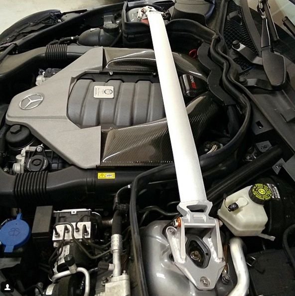

This is where tensile strength comes into play
Further more, tensile strengths increase over a shorter distance travelled.
The Renntech piece is actually not carbon in the middle, its carbon wrapped over aluminium in the centre bar.

Probably not much different from the one Kriston had made. While the Renntech design doesn't have the two longitudinal bolts where it could potentially flex, it is still made of aluminium and unlikely to add any real stiffness to the front. In other words, with the single bar it is about as useful as the SMERC. I can easily bend that thing by 1/2 inch or so just by moderately pushing down on the middle of the bar with one hand, and it was pre-tensioned to boot (as in mounted with the car off the ground so that when you lower the car the wehicle weight on its own would already put some pressure on it). IMHO an aluminum bar is much too soft and flexible to make a real difference especially when you only connect it to the shock towers alone and on a car that already has a fairly stiff front chassis like the C63.

Hi There,
It uses your stock strut tower bolts.
Please ensure you verify the correct sides (left and right) by checking the bottom side of the mounting brackets. We had them notched out to accommodate for the stock plastic fasteners the brackets cover.
Shoot me a PM if you need any help.

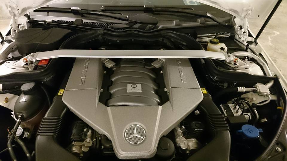

I installed my MB TrueNorth strut bar today. With a pana roof, my car has its share of rattles. After gotten the bar installed, the interior rattles have been much less. At any rate, I like the results...some may say it is a placebo effect but I think it is money well spent.

Interesting thread. I am also thinking about a strut brace given I have a track width on my car that is about 120 mm wider than stock and am getting full blown track wheels/tires for the coming season.
Still thinking, but have a few observations, that I would like to test here:
1. There is an Alutec brace all over the internet, including Ebay, that looks exactly like the MB True North one Kriston is writing about. Same design, same welds, same notches for the plastic grommets. It runs for around 300$
2. The stiffness debate is flawed in many places. Bending stiffness is driven way more by shape than material strength (as Diabolis also mentioned). Think tube vs solid rod. The tube has almost all the bending stiffness of the rod at a fraction of the weight. The longitudinal strength of the tube is way lower than the rod though. So, if you want bending stiffness, going thin and large is the way to do it.
3. The pivoting bolts: The point of the brace is to prevent the strut tops to move inwards under stress, i.e. to prevent the strut mounts to move closer together. I do not think being able to rotate around the bolts makes a difference in transmitting a push force left to right. But stiffness against bending the brace under push load is critical.
The MBArt brace has 2 steel tubes of 7/8 inch diameter (wall thickness not specified). Is the Alutec brace thicker than 7/8 inch? Thickness drives bending stiffness with the 3rd power, if I remember my material strength classes correctly. 7/8 to the third power is 0.67 or 2 thirds of a 1 inch tube for example.
Thoughts?

The Renntech one looks the most flimsy to me - and is the most expensive. The MBArts may be the best value and maybe also the strongest - but least suitable for 'dressing up the engine bay'.
