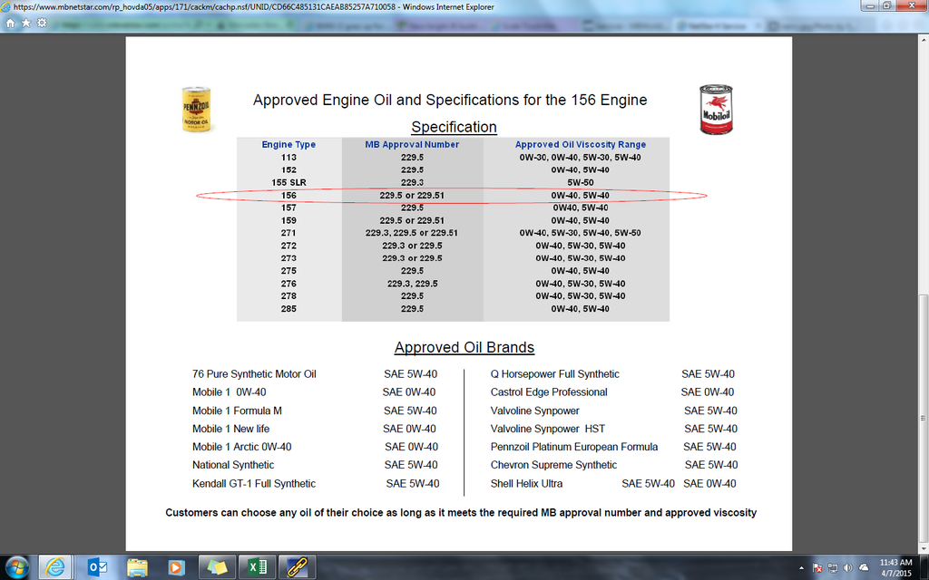

Originally Posted by ScGRaceR
OIL: 9 quarts with filter.
Mobil 1 0W-40
Mobil 1 Formula M 5W-40
so is it 5w-40 or 0w-40? I think when I got it changed at 5k they put in 5w-40

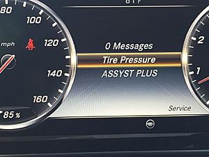

also to help you with finding the service menu
On your multifunction display use your left arrows on the steering wheel to scroll left in the menus <-- -->
when you see SERVICE
Use your down arrow to select ASSYST PLUS and that's where the car tells you when the next service is due

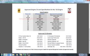

W212 E350, 2013 Boss 302, 2014 Jetta TDI
uploading more info lol
Old Apr 7, 2015 | 11:47 AM
ScGRaceR's Avatar
Joined: Jan 2015
Posts: 27
