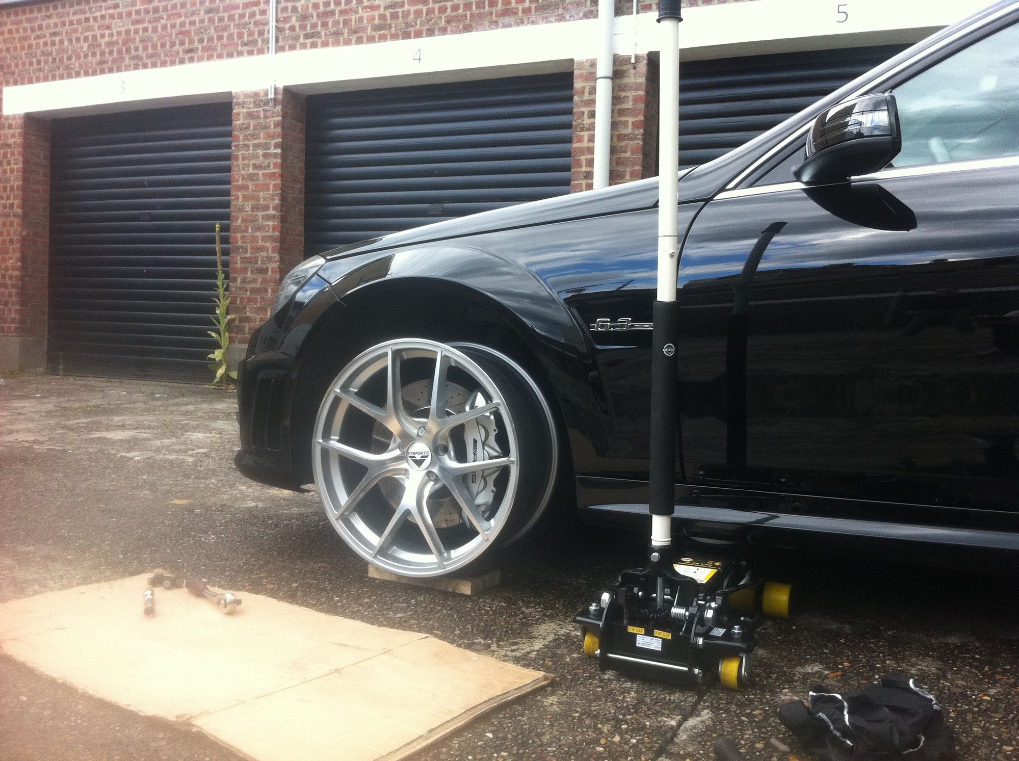

I wonder if someone else have driven a C63 with these specs :
front 20x8.5 et40 + 2353020
rear 20x8.5 et40 + 2553020
I would like to hit these wheels on my car but dont know what tyres i should fit ....
thanks for sharing your thoughts.

Tire sizes seem good for 8.5" all around.
The 30 sidewall will help with clearance and won't have a fat sidewall in the rear.
The 8.5 +40 front will be flush, the rear should be ideally 9.5 +45, so you can make up the width with a spacer 20-25mm, you should be safe and flush.

Sorry, but if the rear wheel needs to have a 45 offset to be flush, then a 40 offset means it sticks out 5 mm too far. A spacer will therefore not help.
