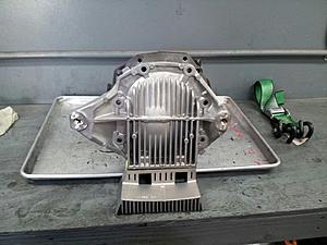

I did wavetrack and updated all seals and bearings and placed OEM cooling fins. Very Very pleased. The car is awake now out of corners....

That heatsink is on the wrong way around. The fins should point forward under the diff. Was it installed like that?
Your 10000% correct just taking pics and showing parts to me by tech. Not on right. No it was installed correctly. Good point...
