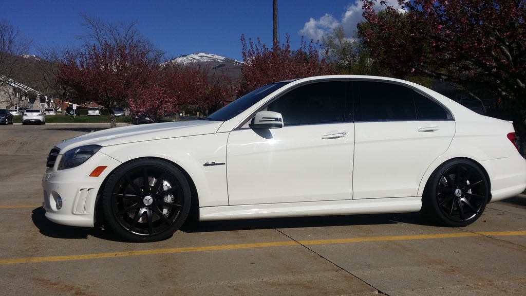

you just need to know the offset and dimensions. What wheels are you looking at exactly?
I have SL63 19x8.5 +45 offset and 12mm spacers up front. and 19x9.5 +45 offset no spacers in the rear
I have to run spacers because the spokes will not clear my brakes.
