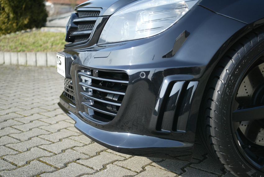

Or be this guy

What is that just a supercharger? How is that relevant to the discussion.

Part of the whole discussion is price, and both those actually are cheaper options.

What is this? I have never seen it? Is it a supercharger or new intake?

HMS supercharger (made by Kleemann)
