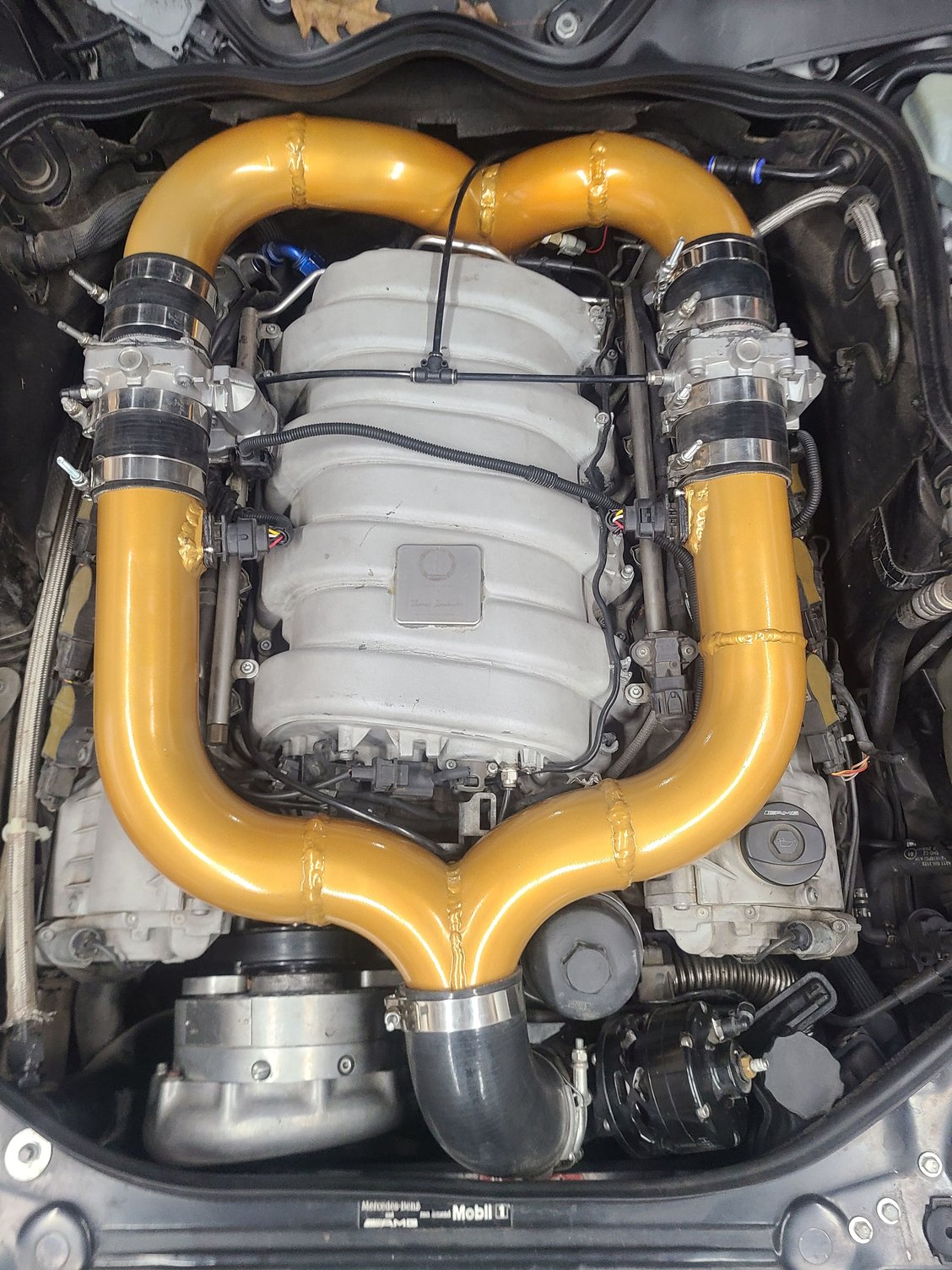

Walk through would be tough, throttle bodies have to be relocated, fan has to be cut completely out of its molding and reattached, radiator has to move as well as be replaced, oil feed lines have to be rerouted/tied in with AN lines, make transmission lines, cut the intake manifold for access and do some welding on that guy. Send me a dm and I'll show you some pictures.

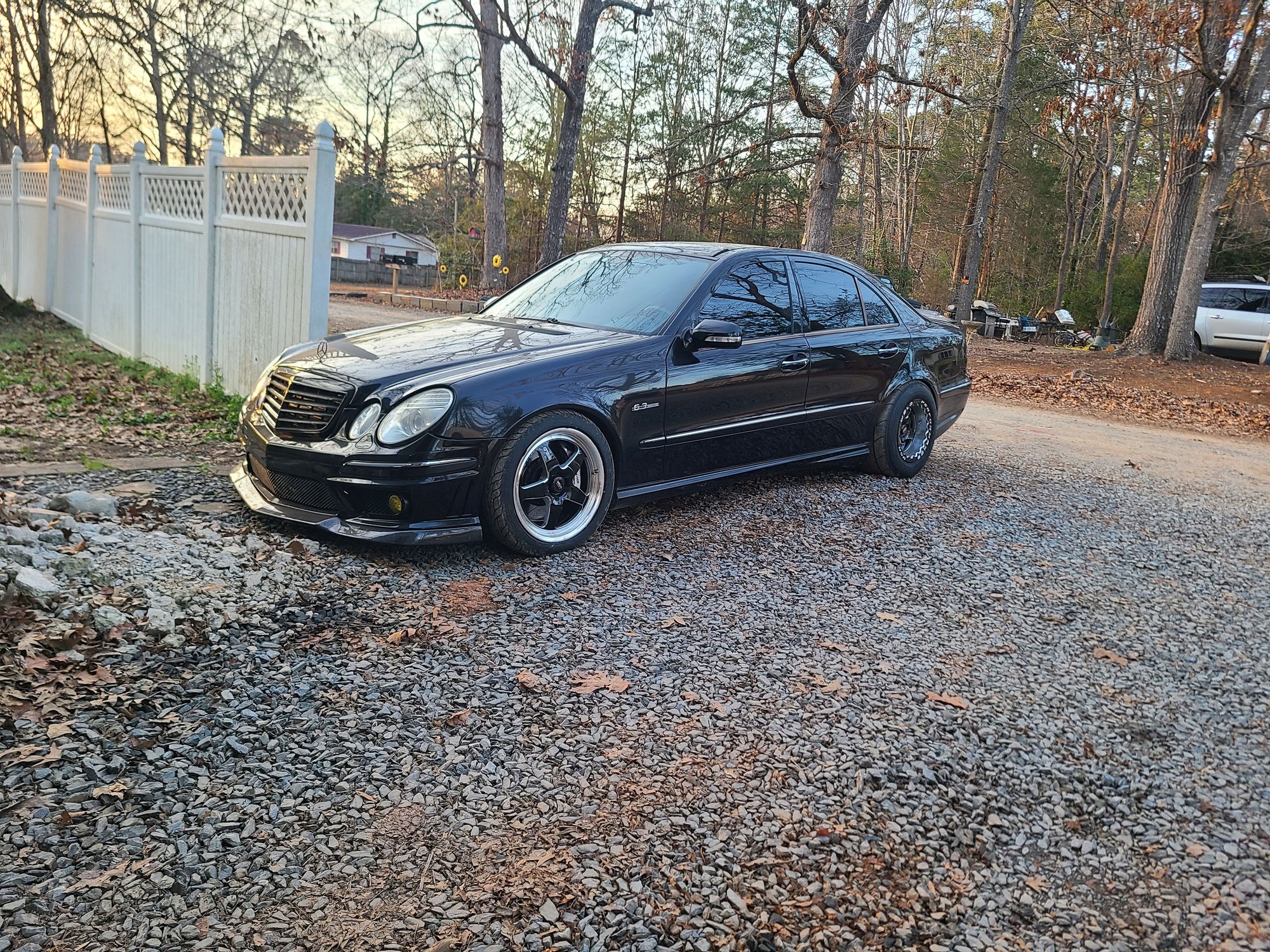

2007 e63
Rebuild was cake. Had a bearing making some noise for a while, she finally let go pulling it back into the shop. Ordered a different wheel, but there wasn't any contact or anything in the intake.
I posted a picture a few replies back, but it may not have uploaded. Service is pretty rough in here. Here's a picture of the hoopty along with the engine bay

What's the intercooler setup look like?

it's a 1000hp a2w. Right in front of the engine.

Plumbed into the stock water system? Or do you have a separate res/pump for that? Just found a procharger on marketplace so apologies for the questions.

Nothing wrong with questions. Its separate, on its own system so you can throw ice in it if need be. It's a lot of fabrication to get it all in there, if ya go that route.

Not what I was expecting at all. Great use of mass air flow sensors and moving the throttles out. This is pretty slick setup for diy. I'm most amazed the stock intake manifold hasn't blown up or is it just a cosmetic shell at this point? I didn't think it could handle more than 3psi lol. I don't think this could fit on a C63, the engine bay is much smaller length wise. You'd have to do a half size radiator like old hondas to make room. What's the corrugated tubing between motor and bov for? Have you done any draggy times? This has got to be pretty high on the list for fastest m156 cars. thank you for sharing!
Thank you sir! So the hard line is flexible coolant tube. Used it to reroute around the intercooler. Intake is pretty much a shell, still has the runners and all, but the flaps are locked out. It may or may not be welded in a few places lol. Haven't hooked the draggy up yet, just got the maf scaled to 3 bar and making decent power. I think there'd be room, lots and lots of relocation lol. Speaking of hondas, have one of those making 600 on 12 lbs lol. Supposed to have a biklet intake coming that will fit under the hood, it's been almost 8 months on that. Also have a crankshaft guy I use regularly, we've found billet rods that match up almost exact. Close enough for an over or undersize bearing would take up the difference. Hopefully she'll be pretty quick soon.

This is a pretty cool setup.
Major props for doing something original with the platform.
This also might be the most viable candidate for that billet IM that's supposedly just come to market.
Did you route the intake tubing / air filter into the wheel well area?
