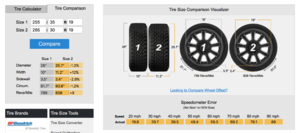

Hmm, if I'm not mistaken then BLKROKT has 285/30/19 in the back of his car and now when you compare it with 255/35/19 then it looks quite similar, besides the width? Damn, I wish there was somebody with this setup who would just say that staggered winter tires will work without problems so we could go ahead and order our tires
Yes, BLKROKT's 285/30 - 19 tires calculate out to a theoretical 25.7 inches, so the 255/35-19 does not sound so radical now . . .
