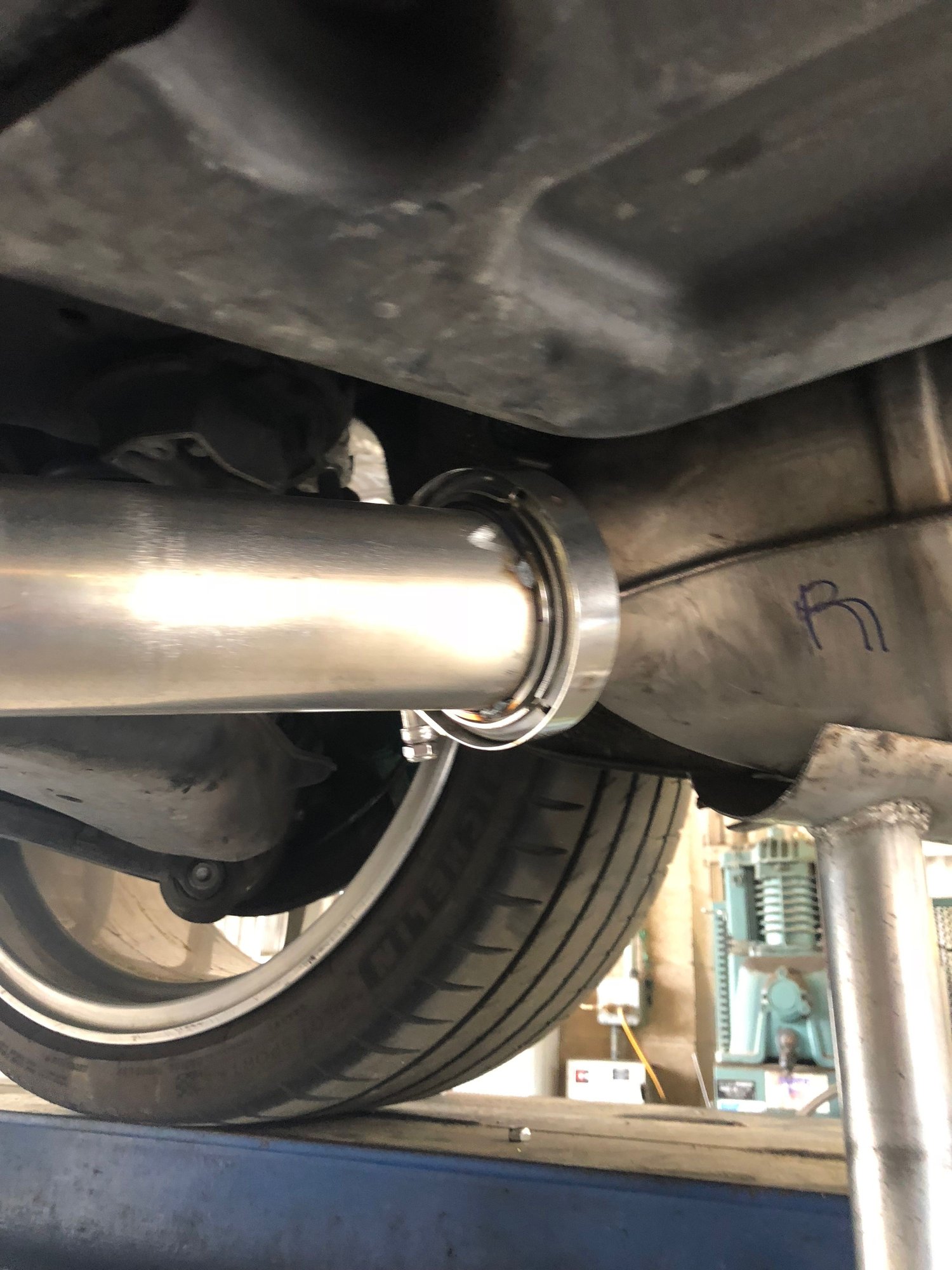

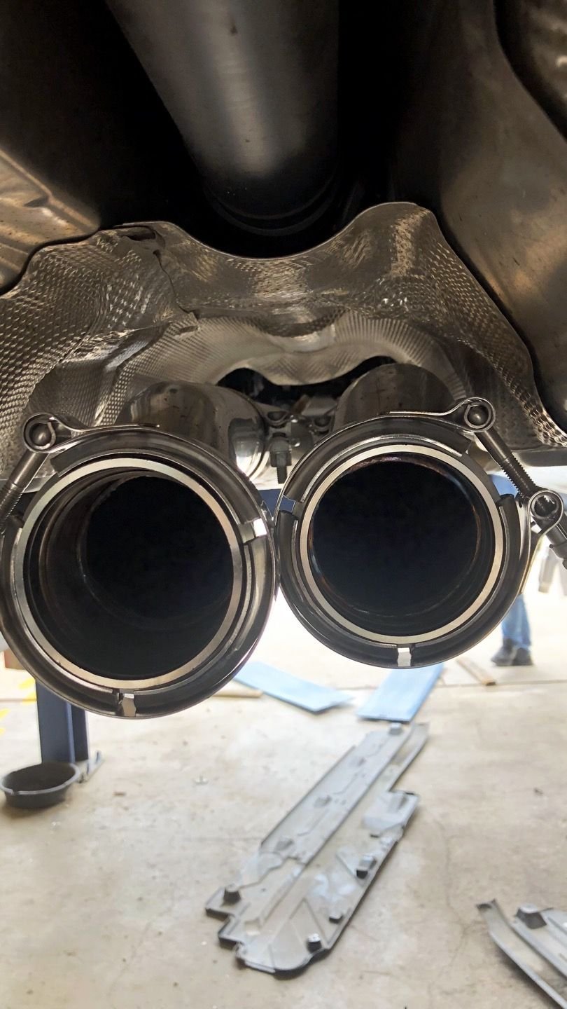

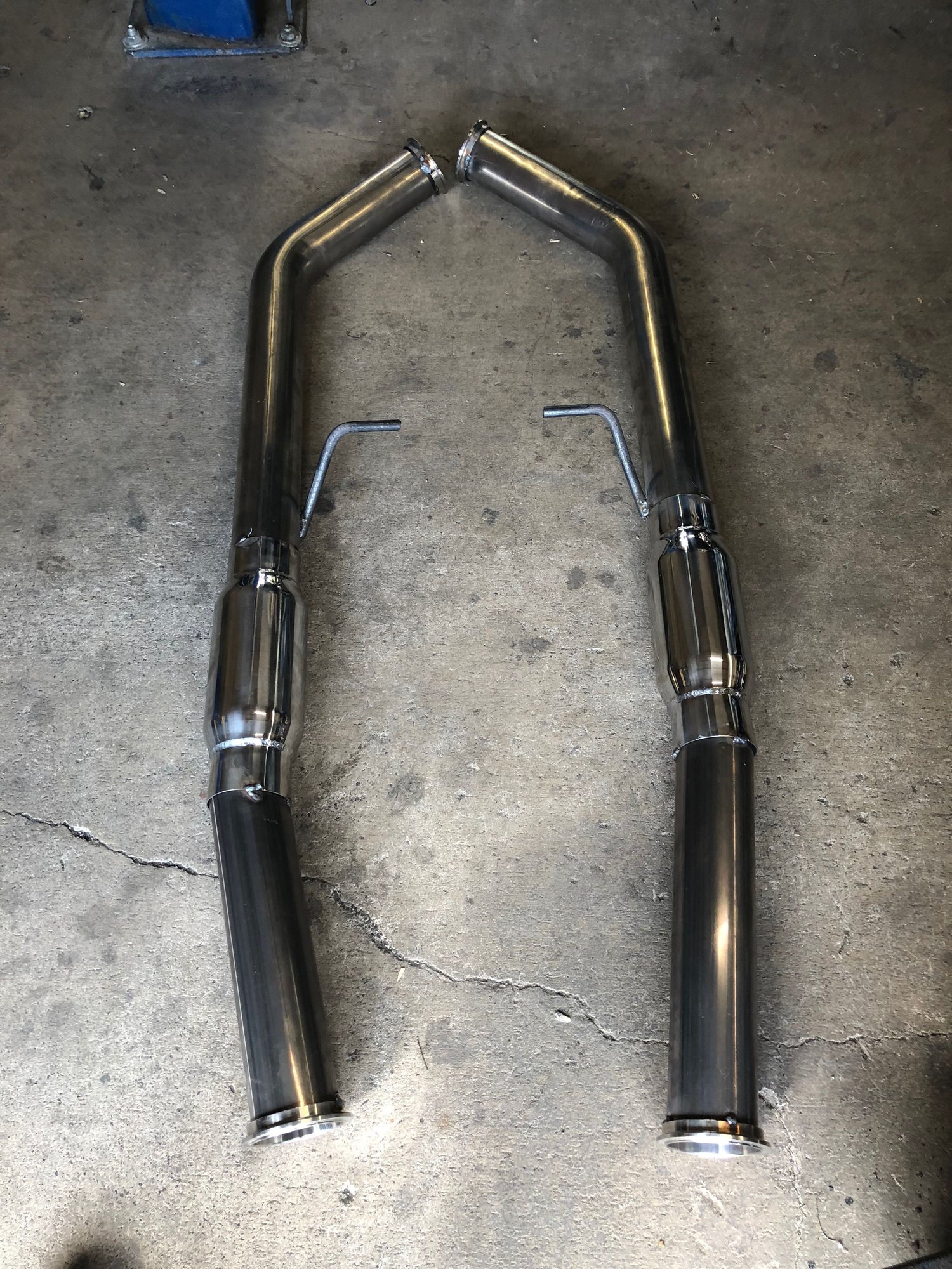

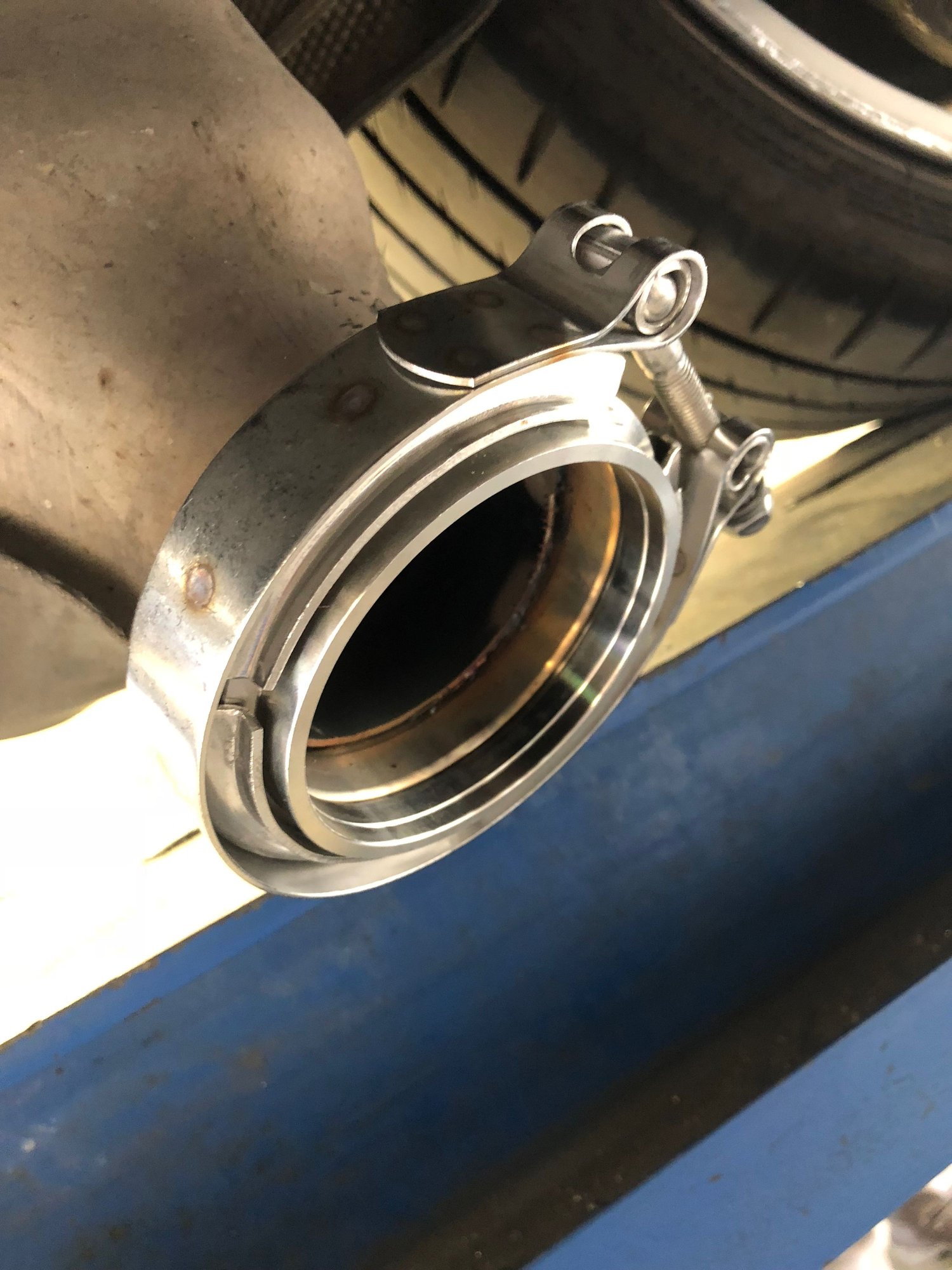

We got started with my modest version of this project over the weekend. Adding 3" ss pipe from the X pipe to stock cans. Used separate resonators in place of the oem. Vbands will make it super easy to swap if we decide to change anything. Got everything tacked and sent out to be TIG welded. After we fit the new rear section, we are going to add vbands at the header collectors and weld up the remaining connections. I'm really interested to hear the sound and looking forward to sealing up all the small leaks in the slip fittings. So far $1100 parts and labor. Might not be as "pretty" as off the shelf bolt ons but should get the job done for about half price.
