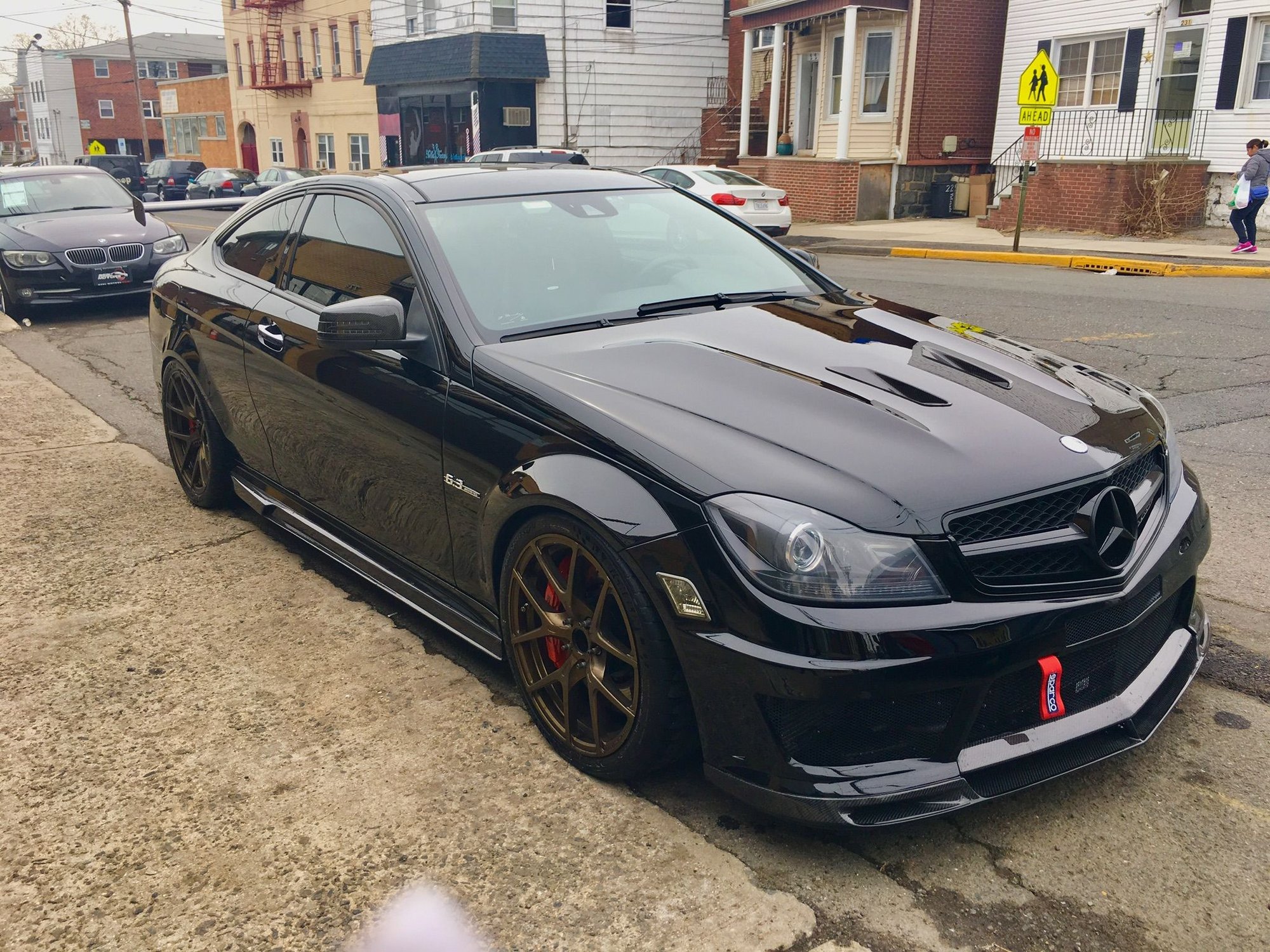

seems like not alot of people have rolled and pull their fenders. I think this could a great mod for those who don’t want the trouble of fender flares and also be able to run wider tires.
by pulling 10mm out we could run wider tires and i think this could a subtle but different look from the rear view.
what yu guys think?

I love mine. Have 295’s back there now with the car slammed and could get a 305 back there with a less aggressive stance. Looks factory.
It’s not an easy job though especially getting the shape to match both sides.

A friend of mine here has it and it looks similar to the job on BLKs car. I like it...but don't pull it out too much and loose the flat, factory rim...the pic above is about perfect.

I agree. It look really nice and subtle. Makes people scratching their head why it look different.

It's rolled an pulled.
The pics are an example of what rolled and pulled looks like in this rolled and pulled thread.
He also loves his rolled and pulled fenders.

These 2 are pulled and flared. I tuck a 295 as well. A 305 is definitely doable if im not slammed.

100% paintwork is needed. My car was also stripped down to bare metal like Kriston’s. You’ll also need the BS fender liner and trim it to fit.
I initially had had the fender lip just rolled temporarily so I could stuff a 285 back there for a trackday, and the entire edge chipped and cracked.
