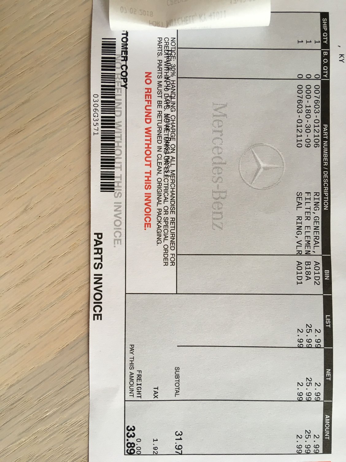

Good evening everyone! I’m looking to change my oil to liqui moly on my 2013 C63 AMG and just had a few questions. I purchased the oil filter part #000-180-30-09. The dealership also gave me lower oil pan seal part #007603-012106, and engine block drain plug seal part #007603-012110. Is this all of the parts I will need to complete the oil change? I was wondering if I need a crush seal for the oil cooler and if anyone knows that part number or are all of the seals the same size? This is my first time changing the oil myself on this car so I would appreciate some feedback. Thank you so much!
