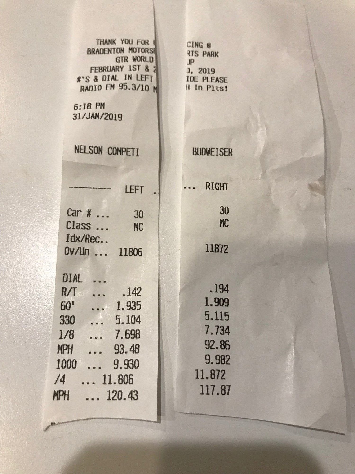

I went back to the track again on 1/17 and 1/31 when the weather was cool here in FL. My car is running consistent 11.8's on Michelin PS4 at stock tire pressure, full weight, and 93 octane. These runs were done with about 1/2 tank of gas. Runs on 1/17 I ran 1 degree less timing than my dyno tune and dyno tune timing on 1/31 runs. Second run on 1/31, the ecu was pulling timing as I was getting some knock, hence the slower time and lower mph. I finally went over the 120mph mark with my best time ever of 11.806 @ 120.43mph. I think she can go a little bit faster with more practice but without spending a lot more $$$ on next set of mods (i.e. TB's, nitrous, supercharger, drag radials), she is pretty much tapped out. I'm really happy with the HP Tuners product and recommend it to anyone wanting to datalog their car's parameters or tune their car , or have me tune it.
