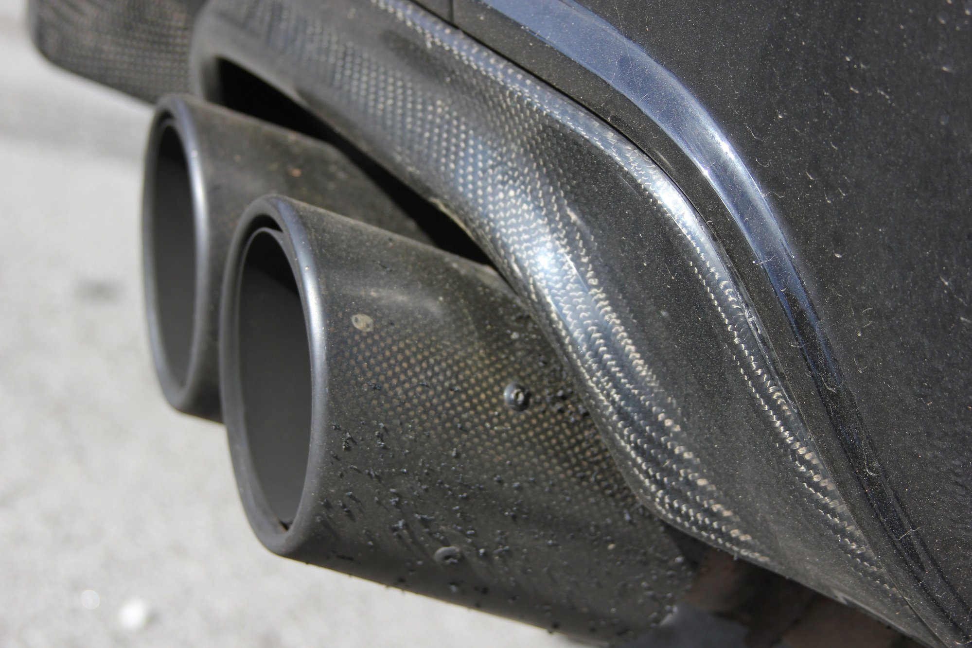

I also did find a exhaust I really like the look of. I attached pics. Does anyone recognize this exhaust?
Let me know what your thoughts are on what I should do. I do miss the AMG bangs.

I believe the exhaust in the picture is Remus. Maybe straight pipe with Remus tips.
