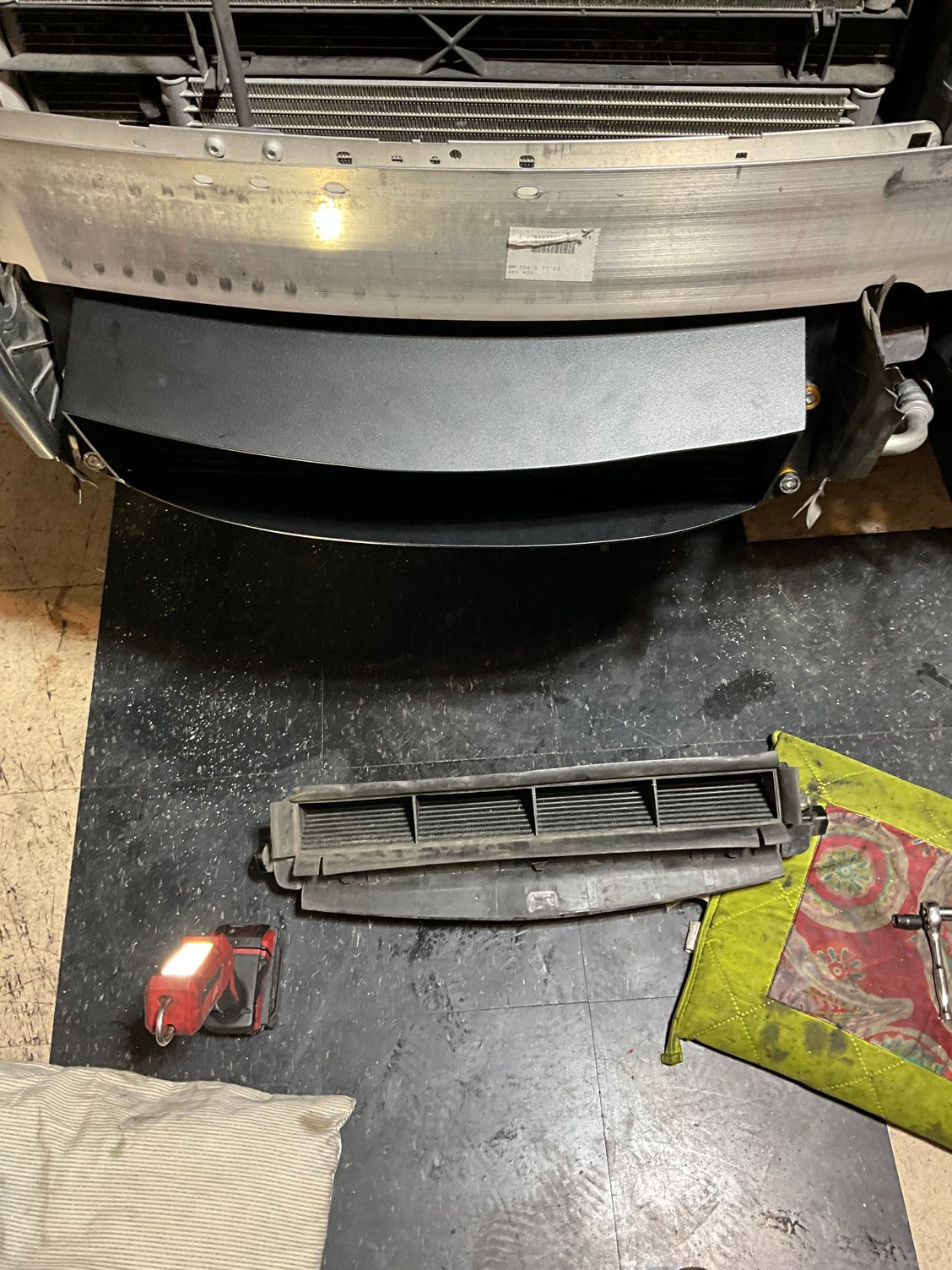

Originally Posted by LoFox
The new cooler just arrived! I’ll post pics of the install in the coming weeks along with some before and after oil temp numbers.

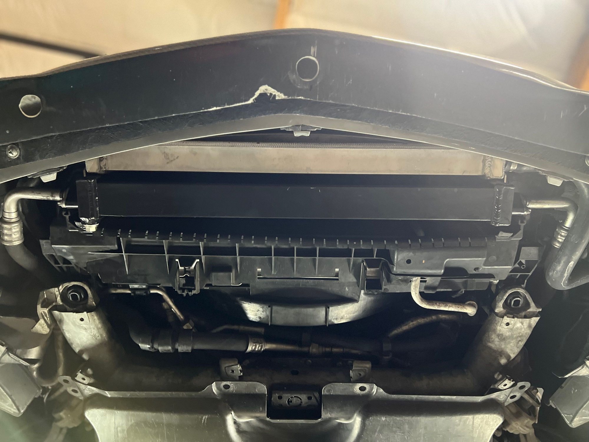

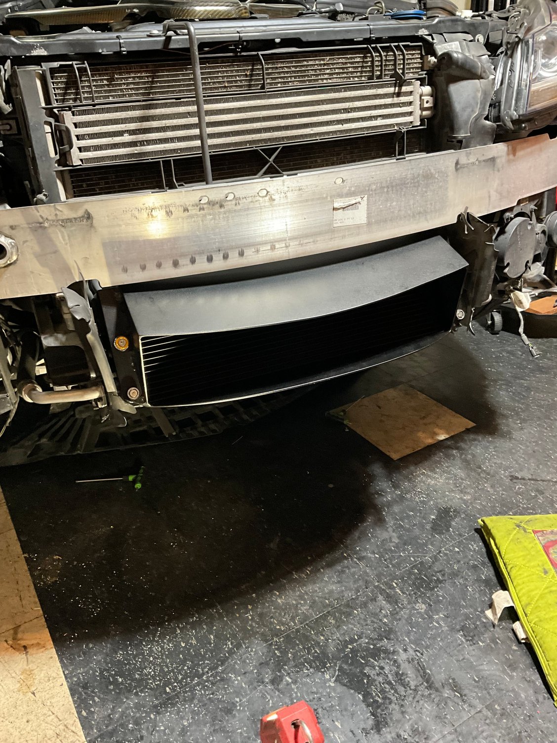

New cooler is installed, overall very quick and easy. I did have to shave down the bolt hole by a few millimeters for both of the oil lines as it didn't quite line up with the threaded portion on the cooler once the lines are attached. So far after two days of driving I'm seeing oil temps are lower by ~15F, basically what they were prior to the supercharger install.
I'm very satisfied and absolutely recommend this cooler for anyone looking to address oil temp issues (be it as part of a supercharged system or a just from track time.)

The install was very simple, everything fit together nicely with minimal persuasion needed. I resealed the lower oil pan at the same time and everything is great with no leaks. I just need to take the bottom panel back off and open up the vents a little more. I was out of dremel discs at the time.
The improvement is unquestionable. It's still winter in the mountains, but it's been 70F a few days where my temps would have easily been 240+ before. I'm not going over about 220 now. Very happy and looking forward to seeing the lower temps as summer heats up.

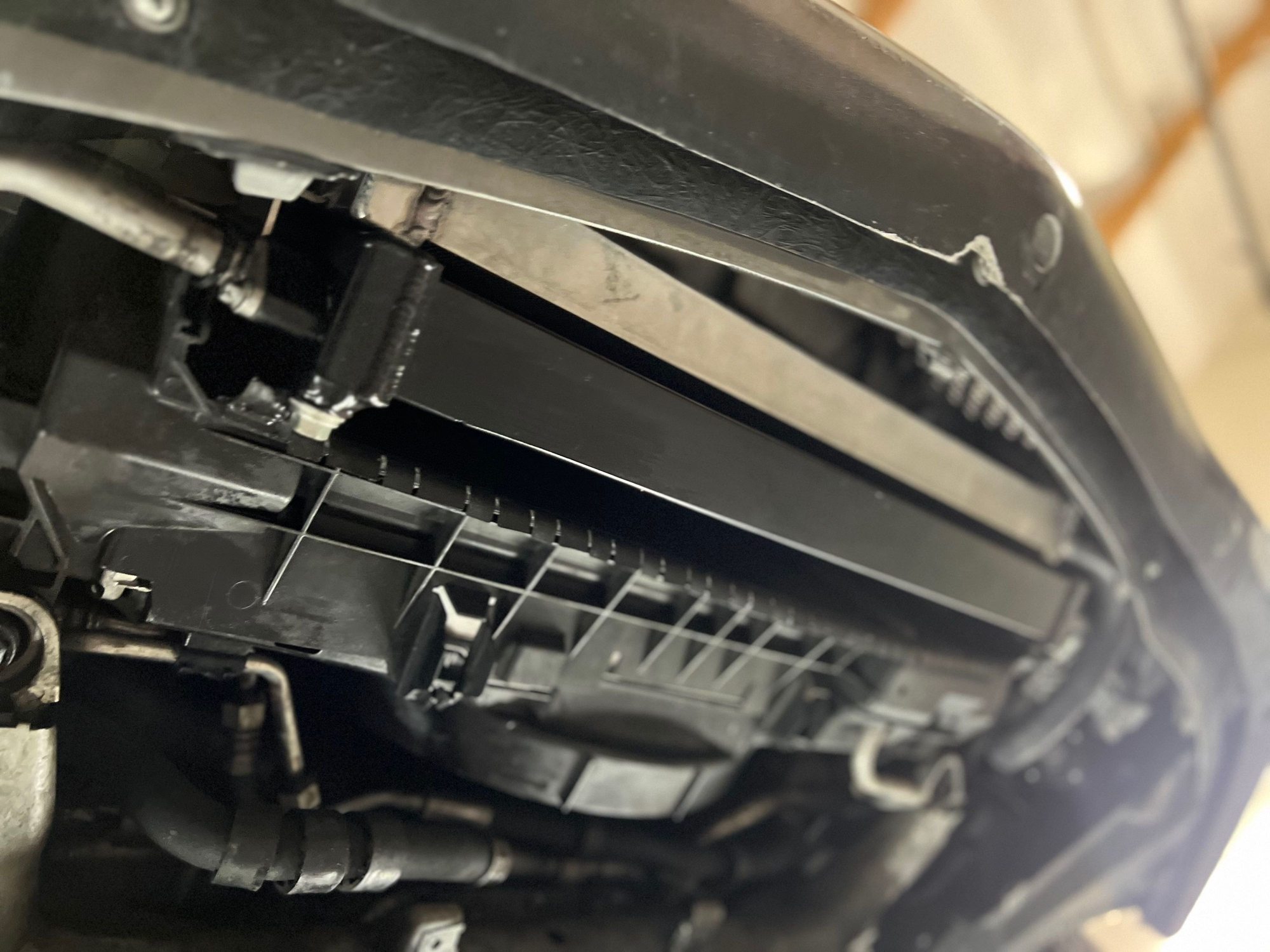

Finally installed mine today after having it for 3 years, on the drive back from the shop that installed it so far it seems on low speed drives temps are the same as stock (obviously as not much air over the cooler), on the motorway (highway) 5-10c lower than stock driving steady to the point it was in the 95-99c range which I have never seen since owning the car from new.
A quick 20 min decent drive going on some straight and twisty roads which are flat/uphill/downhill and in the mountains it never seemed to get above 112c pushing on but I will test it again properly in a few weeks.
In terms of fitment like others the holder holes had to be elongated/washers added and my shop used shorter bolts for the oil lines. No big deal at all with any of that.
BTW I kept the side cooler fan in place and stock undertray for now so there is still more than can be done.

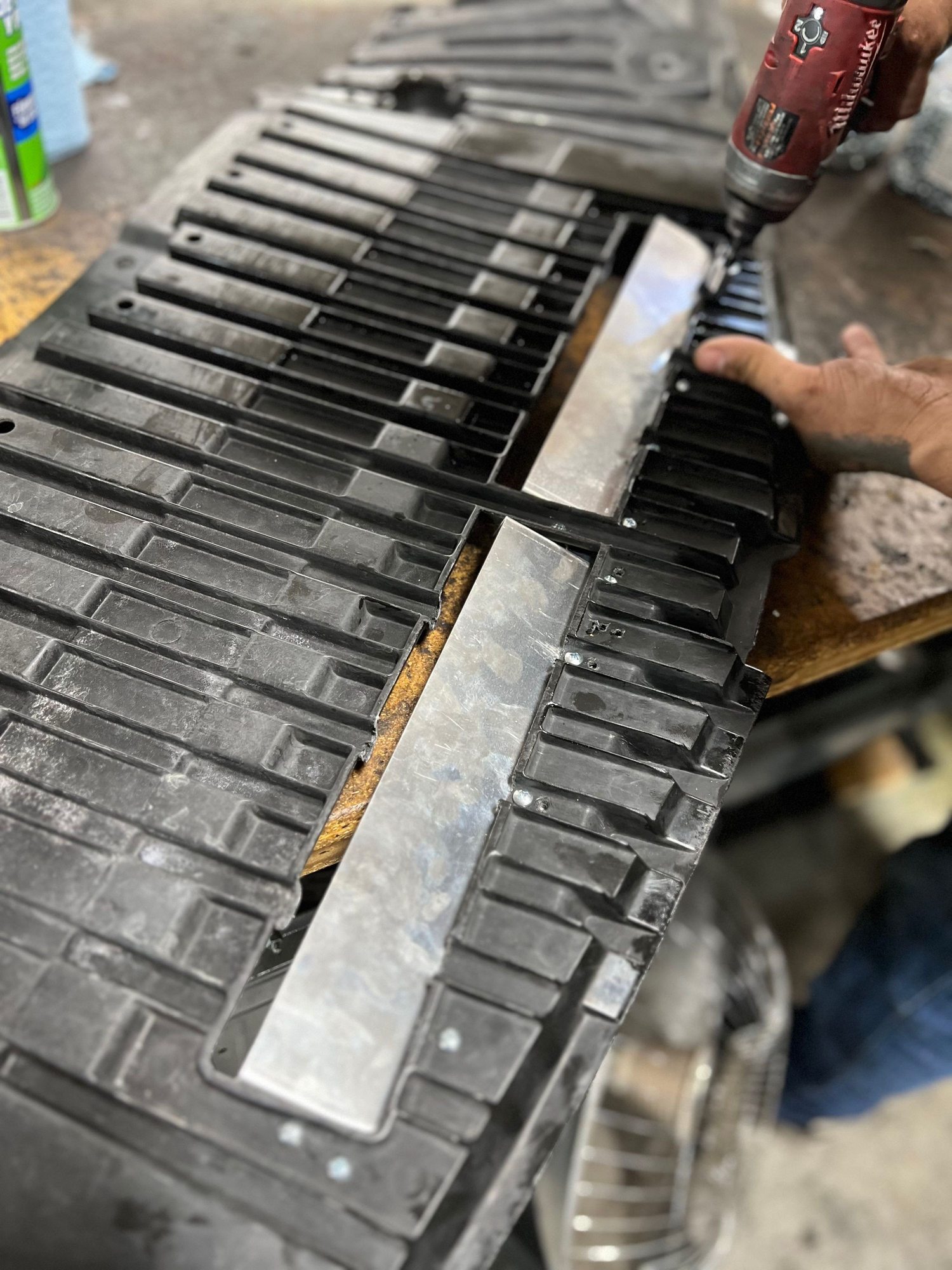

I also kept the side cooler in place. I did install the alloy fins supplied with the kit to the undertray, so I guess that also helps flowing and extracting hot air through the oil cooler.
