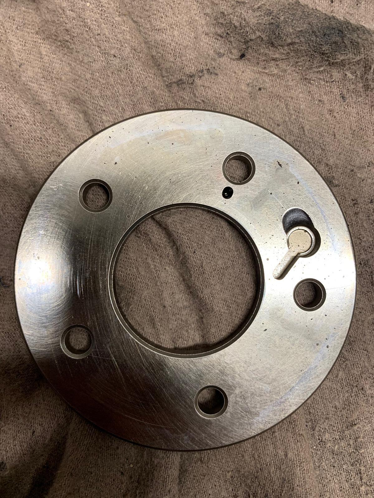

If you hear the adjusters, that happened:
The adjuster always are fine. Only that plate with that little pin have wear. There is a repair kit here in Germany. Only the plate and the pin from a very strong material. Never adjuster problems again.

My understanding is that MB never updated the part, so even brand new ones will wear and get noisy, so the rebuilt kit above may be a better option than just replacement.
Link to repair kit?

C63 AMG PP+ 2010
Unfortunately there is no shop yet. It is a friend of mine who sells the repair kit. I think he sells the kit for about 1300$. Compared to a new camshaft adjuster that costs $750 and breaks down again after 40.000 miles, a good deal. I've installed the kit in my car as well.
