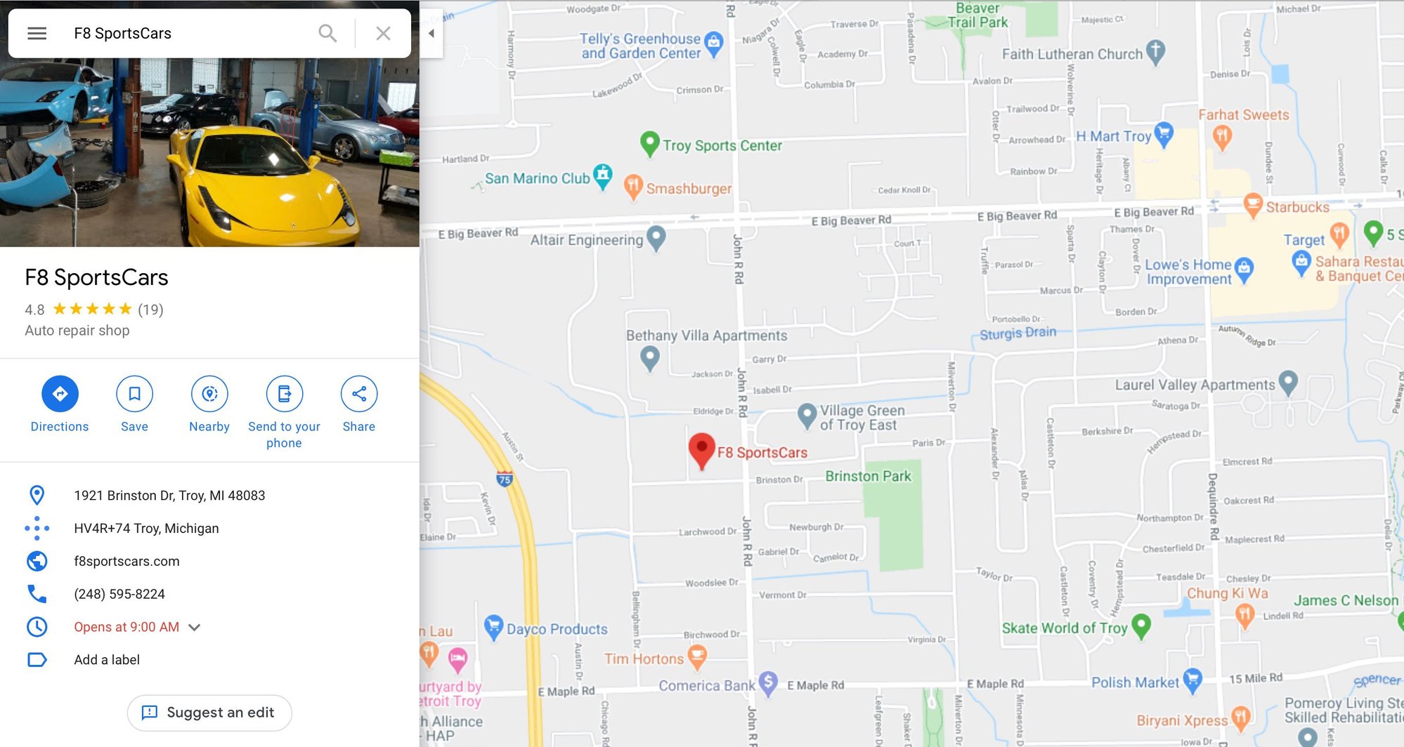

Hey, If your in metro Detroit I would recommend you consult with these guys, Ask for Jeremy, tell him Eddie Xu sent you. Good Luck
