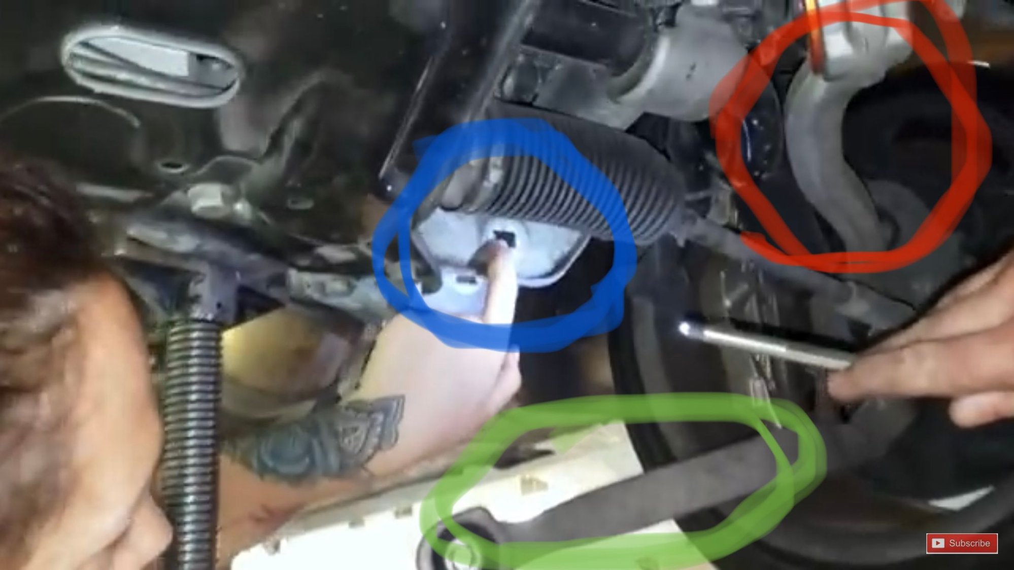

I just had a couple of more questions....The control arm is circled in red, right? Also, blue circle is where the adjustable camber bolt goes, correct? Lastly, what is the name of the part circled in green? I really feel like a dumb *** asking so many questions, but I’m new to the car and I’m trying to learn as much as I can about it. Thank you.

It’s the lower control arm and it appears you have the upgraded upper control arms/thrust arms from sdw (part you have circled in red)
Why are you only doing the driver side?

Sorry, picture is not of my car. I recently lowered my car on H&R springs and when I tried to get an alignment, the front driver side was -.3 degrees from being within factory specs. The passenger side is within specs. I figured I just do one side for now.
Red is the Torque Arm (UCA)
Green is the Cross Strut (LCA)
Blue is the LCA inbound attachment point.
