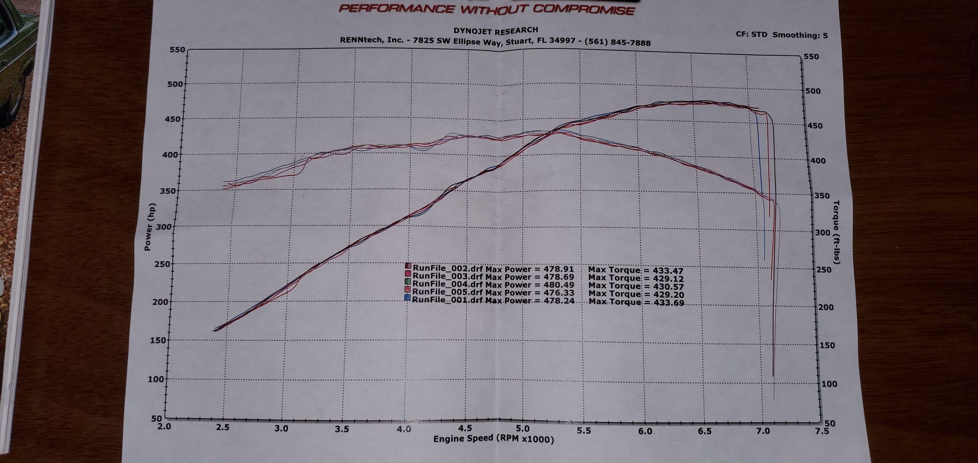

The car made 480.5whp/430.5wtq on renntech's dynojet 93 oct pump gas. It feels strong.

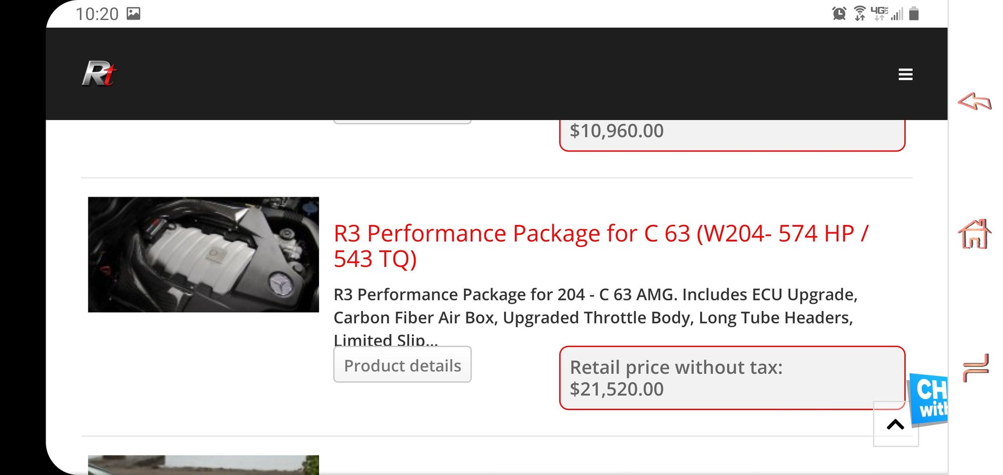

Renntech uses 17% driveline loss value in their calculations. That puts my car at 579hp/519tq crank numbers by renntech's own calculations.
The numbers on their website and the numbers represented to me for crank hp before the purchase was 575hp/543tq for the R3 tune including the air intake and exhaust parts they installed. As you see my car with less than 5k mileage made 24ftlbs less crank, or 20+ftlbs less wheel torque than advertised. My torque value barely rose to the level of their advertised R2 package which had the MUCH less expensive headers in that package. The explanation from the owner, Hartmut, was that cars differ, with not a single attempt to explain further or check parts on my car versus the car they got the advertising numbers from, or to explain if cars regularly differ by more that the difference between their R2 and R3 packages. Obviously being that far from their advertised torque value after buying 'all the right parts' was disappointing and was the beginning of a few more issues to follow.
I did NOT get the transmission upgrade or the LSD upgrade listed as part of their R3 package, so my cost was not the full advertised R3 cost on their website. I was told my trans would be fine without the upgrade and that my car had lsd from factory (I guess they assumed all 507s had one, wrong). Renntech agreed neither of those things would affect a higher gear dyno pull number by any significant amount.
I will say that I don't see other c63s on 93 pump with similar mods making 450wtq or higher,, but for some reason renntech advertises 543 crank tq value for R3 with my parts.

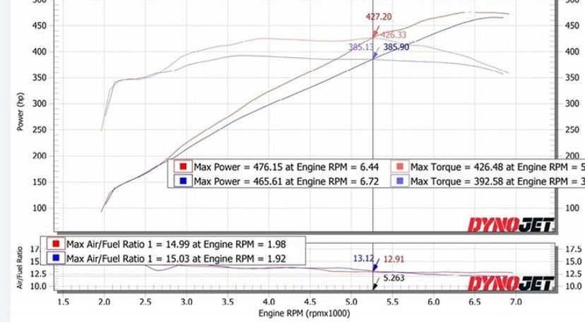

Gas can also make a difference also. Do you have the dyno graph ?[/QUOTE]
Here's the graph, 5 back to back pulls

Here's the graph, 5 back to back pulls all within ~4hp/tq
[/QUOTE]
this graph looks like what a normal c63 does with Mbh or arh longtubes, row’s/filters and good tune. So yes for what you paid for and what you received isn’t exactly ideal. then add e85 and you’ll be close to 500 whp and 445-450 wtq. That’s as much as you’ll get out of this car n/a. If you want more you need nitrous or a blower.

makes it seem odd that renntech advertises 543tq (450wtq) on 93 oct then with their r3 huh?
