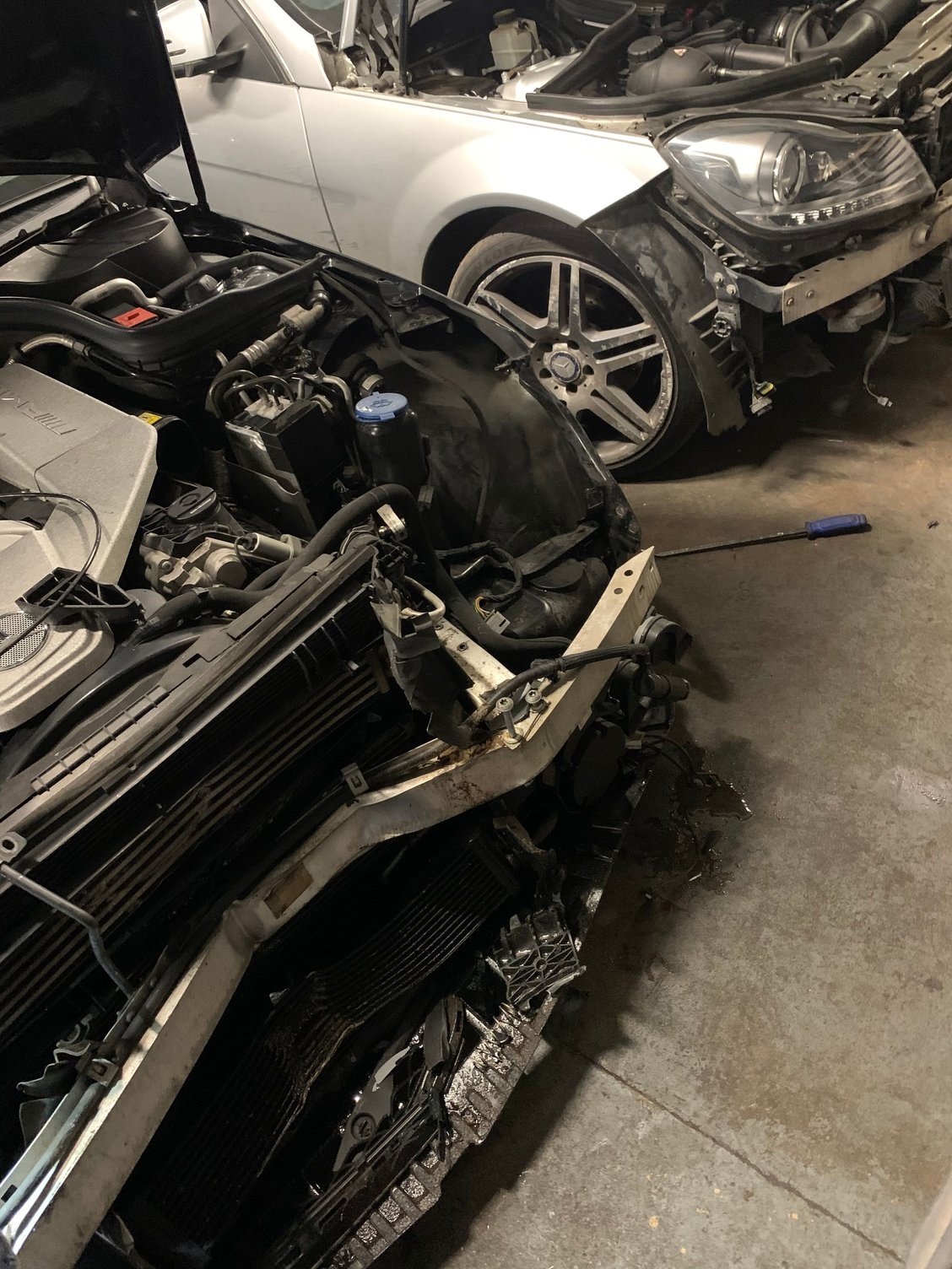

How bad was the front end damage?, also are the batteries fully charged, check this with your scanner if the voltage is slightly low it will not complete the start .
thanks. I have attached videos and pictures

By the look of your pictures I would say you need to clear the ECU codes there will be a code activated that will not let start, or that battery voltage is below start level
