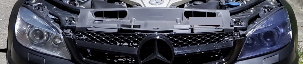

I did not get enough time today to investigate the headlights in depth, but had a few minutes to take some pics.
As suggested, I removed the blue stickers that were on the headlights. Did not turn them on yet to appreciate the difference, will do that tomorrow.
However, the picture here is quite telling of the difference...
I will let you guess which one has the sticker already removed.
Some quick pics of what I could do with the limited time, will get better ones soon.
The other side has an HID, but for some reason the picture did not take, will have to do again tomorrow.
The headlights do not have any kind of part numbers, so likely cheap aftermarket housings...

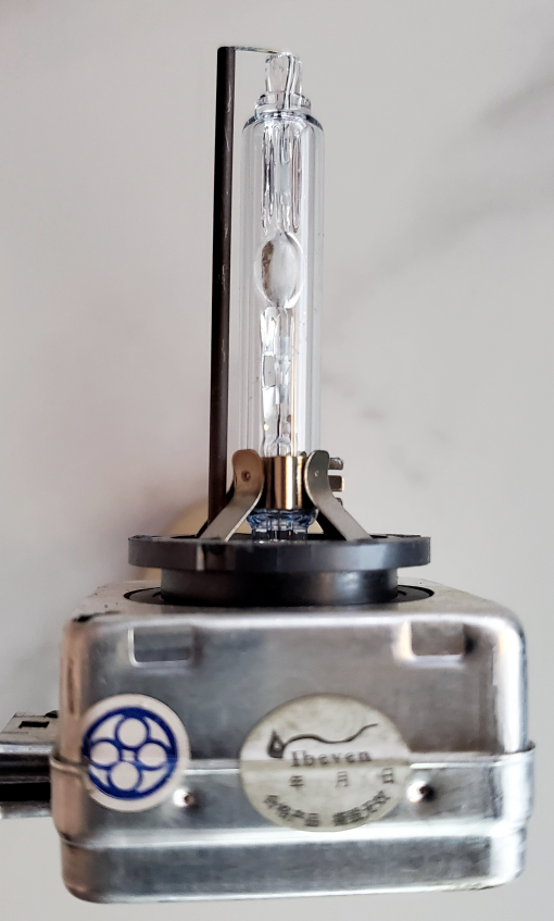

Finally got around to taking care of the lights tonight.
Replaced the H7 and the Xenon bulbs and there is A LOT more light now...(Removing the Blue stickers probably helped a lot too)
I will be adjusting the light pattern tomorrow evening, shifted too far to the right I feel.
The break in the pattern with the diagonal line going to the right is happening in the middle of my lane in front of the car, instead of what I feel should be almost at the lane divider in the center.
The Xenon I removed had the brand stickers removed, so no idea what these were...
I posted a pic for the curious minds. I see a sticker mentions "Ibeven".

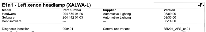

These are the DTCs I was getting, will check tomorrow what is still there... These were all A+S
E2n1 - Right Xenon headlamp
A23955 - The control unit 'Headlamp range adjustment' has a malfunction. The component is not configured.
A8041C - The xenon bulb has a malfunction. The voltage value is outside the permissible range.
A83800- The actuator motor for the active curve illumination has a malfunction.
E1n1 - Left xenon headlamp
A8372A - The sensor for the active curve illumination has a malfunction. There is no signal change.
A83800 The actuator motor for the active curve illumination has a malfunction.
Pic of what was acquired today below. (The bulb visible in the OSRAM box is the old one, new ones have a bluish tint)
Thank you again for the information!
PS: What's up with the strange text export from the PDF files exported from Xentry?
All I get is a bunch of gibberish letters with circles around them when I try to copy text to paste somewhere else...
Had to export from Acrobat to Word to be able to copy/paste easily.
