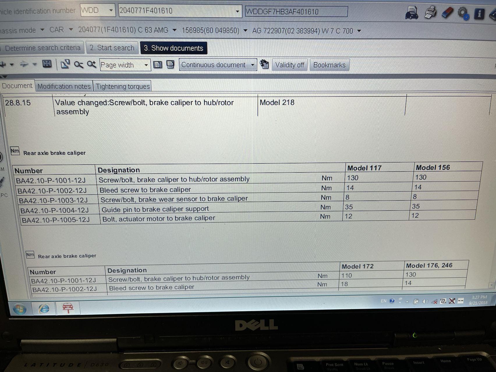

Torque rear caliper to hub
I forget whether this was the question in the past.
