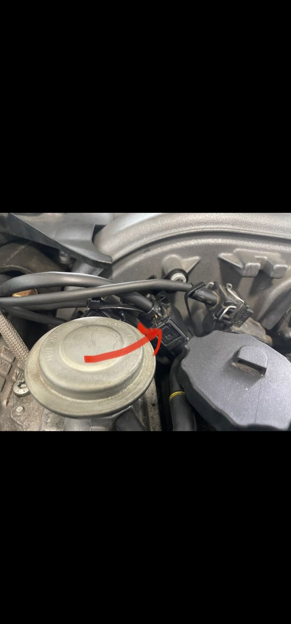

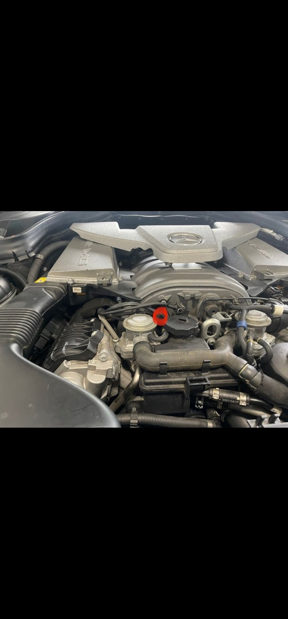

Then take a picture because I am not sure what connector you are talking about, this is the one that usually breaks when you undo the throttle body connectors.

Old Aug 30, 2022 | 05:01 PM
roadkillrob's Avatar
Top Answer: 1
Joined: Aug 2016
Posts: 2,405
Likes: 724
12 C63BS Magno Alanite Grey, 25 X5 Msport, 08 BMW E93, Ducati Hyper 698
That is unfortunate, the car side not the manifold side, usually the other half of the connector is the one that breaks. It may be 905 and 906 on this diagram for the 2 connectors to the throttle body connectors, but not 100% sure as the labelling is poor on the diagram. I did it in my copy of EPC and all the other connection points tell me what they are for or that they are unused on this model, those 2 are labelled basically connector to another harness which the throttles are as the other harness connects to this harness and then to the throttles themselves, so these are maybe the connectors but best I can help on this..
