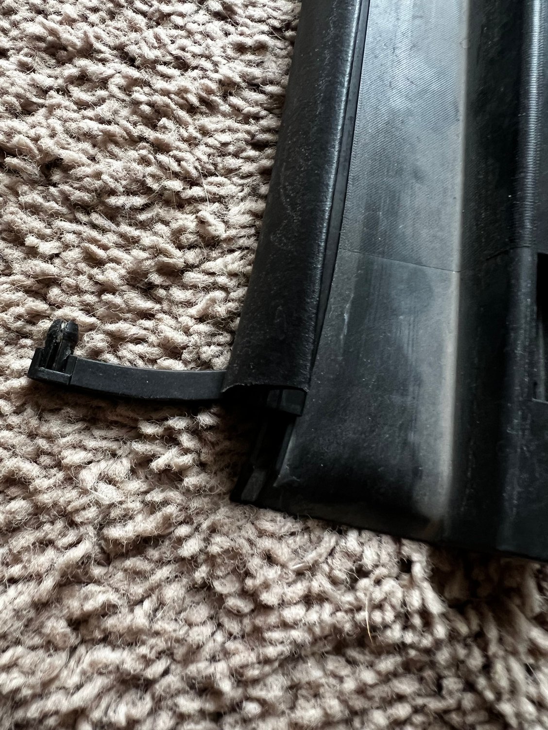

2. Remove the sunroof drip rail. This rail is used to catch water that seeps past the sunroof seals. It’s held on on either side by clipping into each side of the sunroof arms. Simply pinch each side and push out gently. They can snap if you’re not careful. This drip rail is also used to catch the sunshade and drag it open along with the sunroof when you open it, it also keeps the shade from being closed while the sunroof is open. Think of it as a dual purpose locking mechanism
I broke mine the first time from frustration and not knowing what I was doing.
This clips onto the sunroof arm

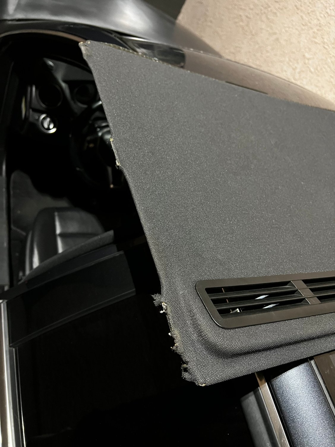

Damaged guides on one side of sunshade
The guides on one side of my sunshade was heavily damaged from the previous owner derailing it. That one side started colliding with the drip rail and all the rubber seals up there and tore it up bad. Eventually the sunshade started catching and would ruin the sunroof motion when opening, causing the motor to click and misalign. This can be fixed by walking the sunroof closed, just tap the button to close it inch by inch. Holding the button down won’t help. You can also pull the sunroof closed while you press the button to help the motor out. When it’s fully closed just hold the button to close the sunroof several times and it will reset itself.
