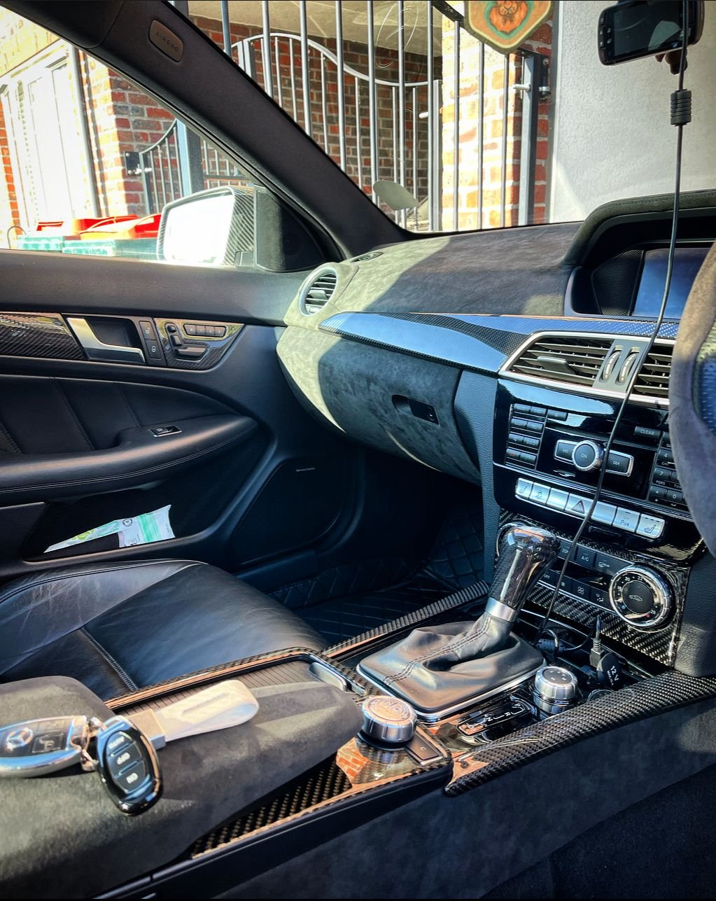

Alcantara Dash - Facelift
Pretty much finished the outside, wide body been on 3yrs. Pretty much finished the engine, supercharger been on the same
Naturally attention has turned to the inside beyond the usual carbon mods we do. Had this Alcantara 9002 piece made and trimmed for perfect fit around the vents. Still have the centre console to do, but pretty happy to lose a slab of cheap material to be honest.

Thanks. I had a UK company manufacture and install the piece. It was made on a rig of a 204 dash and translated perfectly into my RHD car. I am not sure they supply to LHD or the supply only, but I can ask if that’s something you’d like to explore.

You take out all of the trims, clocks etc and fix behind all the trims, so it’s not just a slap on dash pad. Adhesion is your choice, but something like 3M dash adhesive is probably where you’ll end up. This company just takes all the work out of cutting holes, to shape and stitching, I haven’t got patience for all that so great they have a factory rig of the dash.

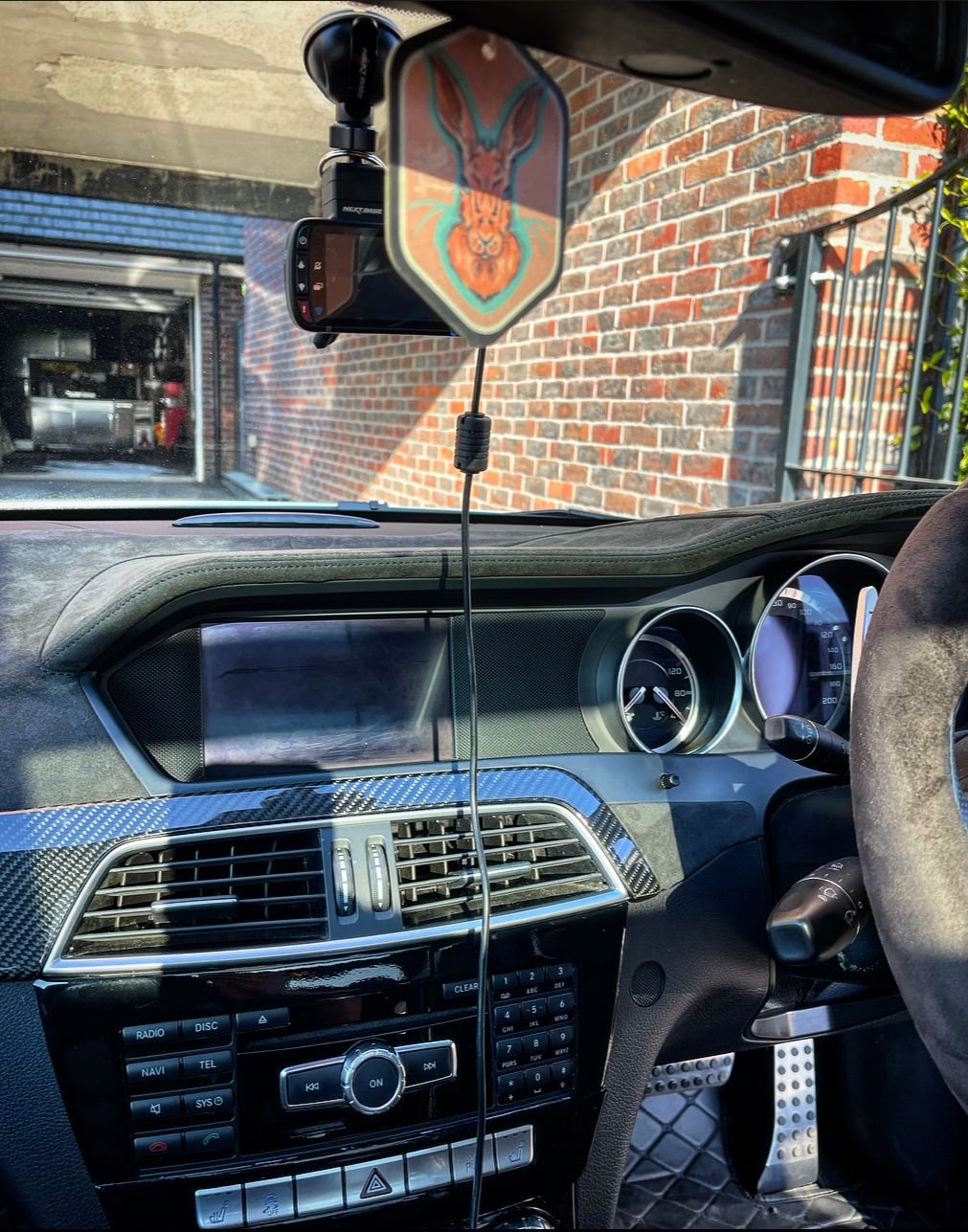

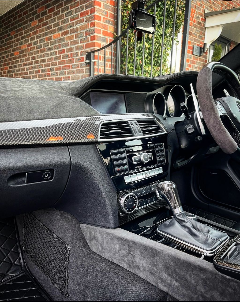

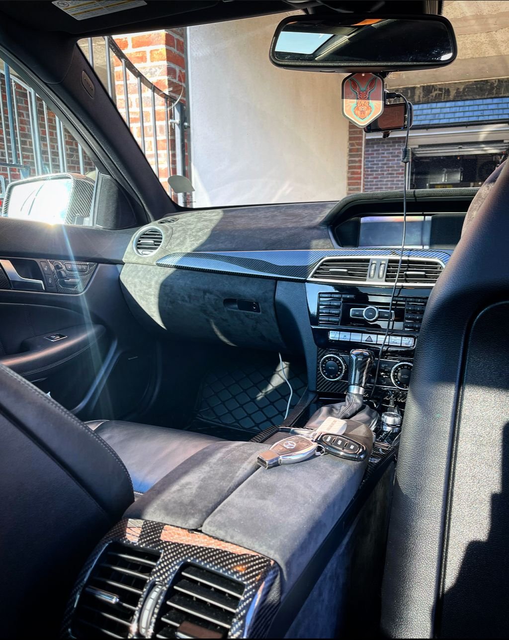

@BHimself Here are a couple of shots. It’s an ongoing project, I’ll wrap to my taste but the possibilities are endless. I considered running a double stitch on the centre console tops but, I have a plan here for a one-off Carbon inlay to TBC. Get a good quality material, genuine Alcantara and not a thick hide (it’s synthetic anyway so pretty slim). The material is super easy to work with, don’t stretch it but it’ll lay into any recess, and you can hide the cuts and any overlaps behind the panels if necessary, then trim them up. A glove box is definitely doable, as are the radio console sides and lower dash.
For me, I realise there are a lot of plastics in this car, so it’s about picking the battles of which to wrap. Mainly the cheap hard plastics let it down, but the spongier ones are liveable. I think next, after the centre arm rest leathers, will be door card tops as that’s another area that catches reflection from outside elements I find, and let’s be real, that’s the point of flocking or covering a dash in “suede” anyway, so functional too. Finally the rear will get some attention around the centre cup holders.

You're doing a great job with the interior upgrades!
Thank you for the extra pics!!
I don't have instagram, and their website is just a "coming soon" page. Do you know if they can do all this in a leather too? @Why Vegas could you please ask next time, or get an email for this old timer?
I hadn't thought about the sides around gear shift/seats either....excitedly watching the project unfold as well!!
I must admit, this looks like a good next upgrade to obsess over while I wait for the coilvers to come in...

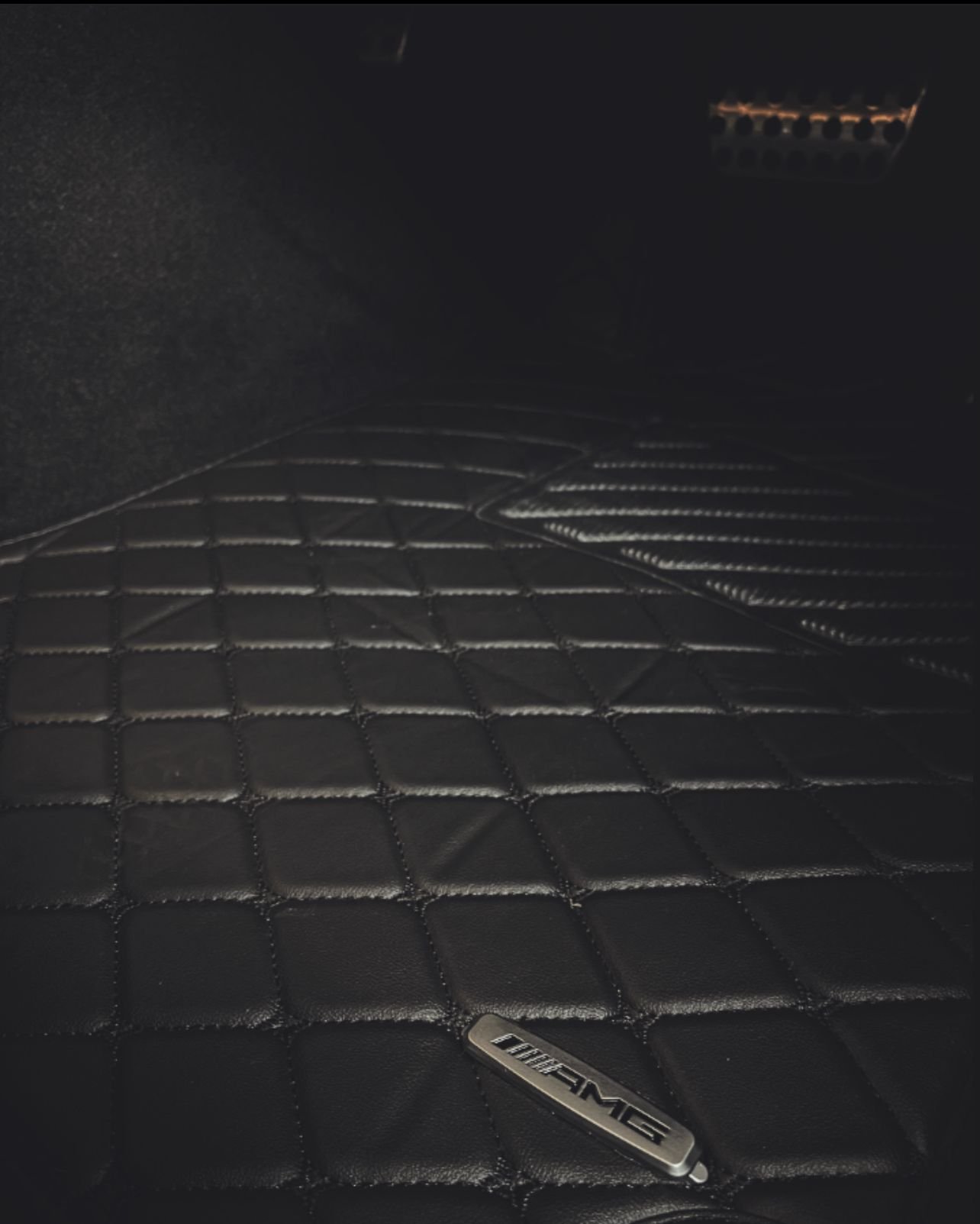

I noticed the floor mats too, those aren't Luxos or Toping mats are they?

Leather was my first thought, but it’s really only possible with the dash out and you’d only have the choice of a real supple Nappa, and have to hope it matched your seats. The problem with it is, is that it needs a lot more work to lay into the shape of things so I doubt it’d lay down right without full access.
I’ve got loads of Alcantara so as and when I get free time, I wrap another piece but just trying to work out the balance, as in what’s missing and then not overstepping to the point it looks too much.
The mats are just something I knocked up myself on the machine. As you can see they aren’t the high sided crap that wraps round everything, they’re just a base that lays over the original floor. If I did it again I wouldn’t stitch them in diamonds, I just took inspiration from photos I’d seen, I’d horizontal stitch. But, their purpose is literally to stop the floor getting dusty from around here, as it was super annoying having to beat the mats out just walking to the car from the house at times. These are wipe clean and throw-away if I want, with a perfect set of AMG mats underneath
for show.

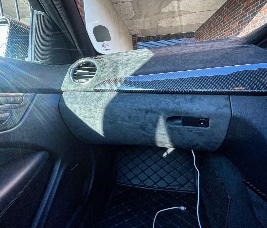

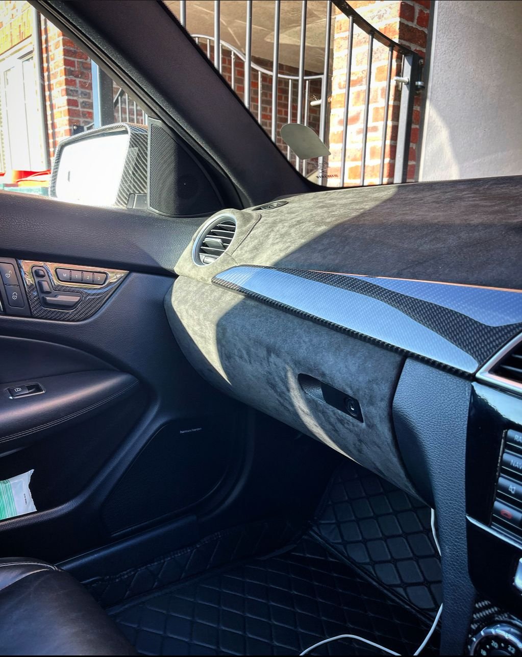

Ok, you were right, I was wrong, the glove box looks better for being done. It wasn’t easy. The contours around the top sides were tricky and so was figure out the best way to cut out the latch hole.
I also did some other bits, like the small piece of dash next to the indicator (turn signal) stalk and the arm rest leathers.
Maybe I will do door tops next, just to finish the cockpit feel, then I’m done.
