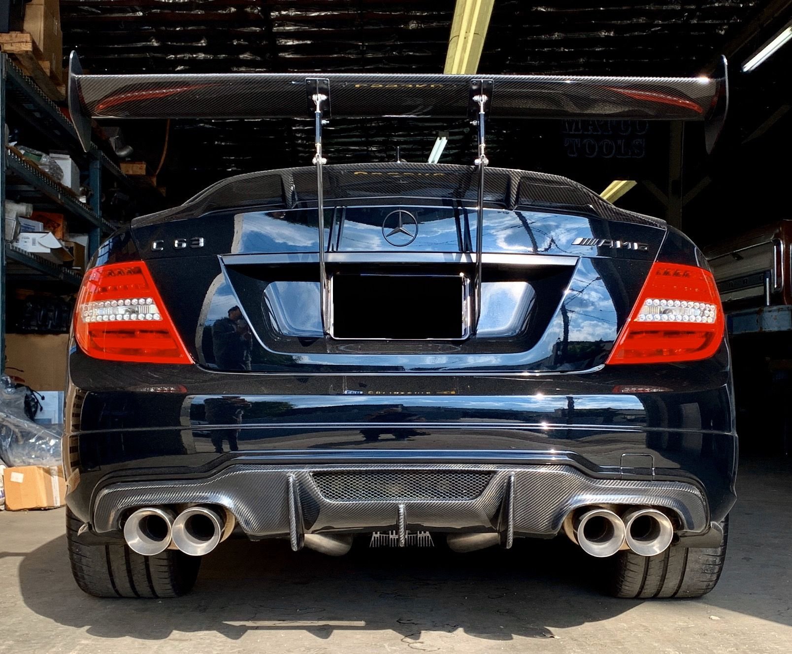

Update:
Got these tips on the car yesterday. I'm happy with the look but the job sucked. Lots of obnoxious cutting and welding to make these work with the stock mufflers.
The muffler outlets are 2.0" into a flared, trumpet-shaped section that the oval tips are welded to. Using these tips required separate 2.0" to 2.5" reducers and a lot of patience.

Originally Posted by sunnys14
what size tips are those?
4"
