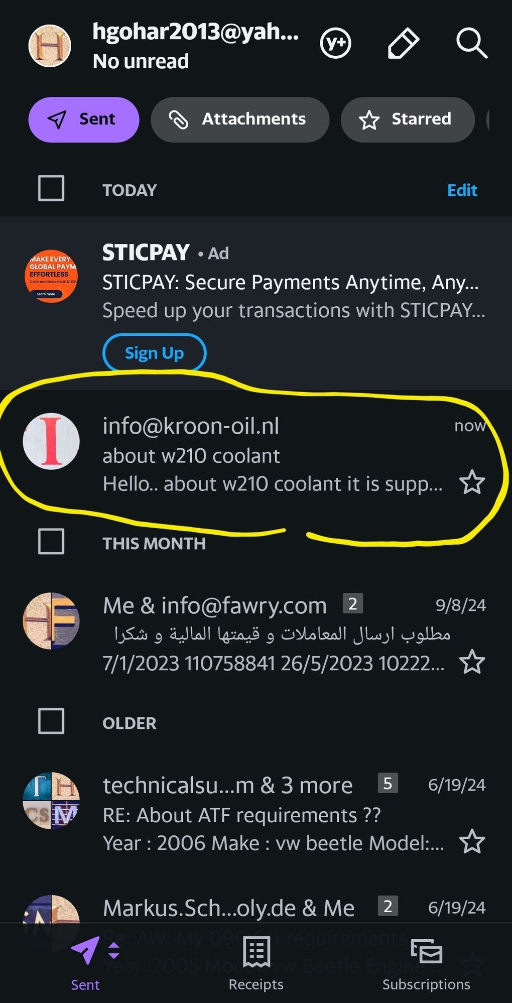

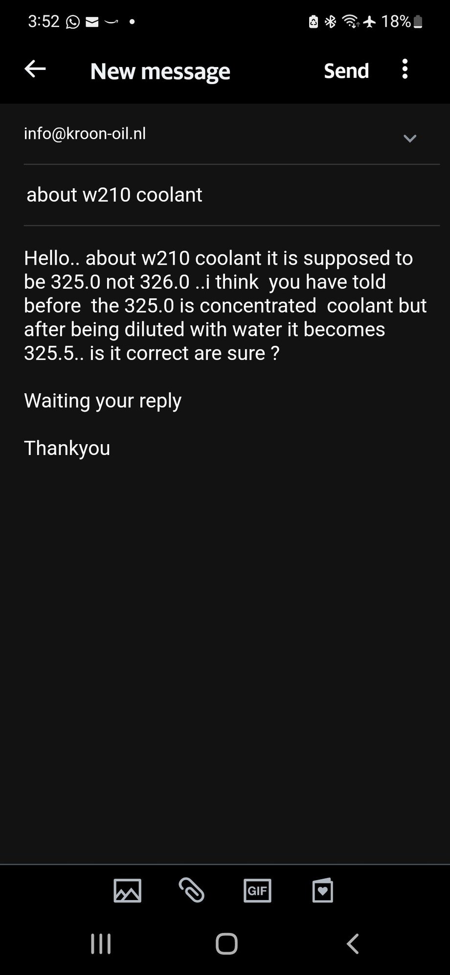

what this means?? Is 325.0 is the concentrated antifreeze and after being diluted with water it becomes 325.5 im totally confused ?i sent him again and waiting his reply...

i think now it is more clear but he reply me to not mix 325.0 with 325.5... some says it is ok to mix 325.0 with 325.5 and other pro told me not ...totally confused

https://cimg6.ibsrv.net/gimg/www.mbworld.org-vbulletin/1020x2000/screenshot_20240923_125604_gallery_dcfaa3bd7dc28fd 10a79453a15e44975967b2c5f.jpg
No, it means exactly what was typed in the image you posted.
This question was directly answered here --> https://mbworld.org/forums/c63-amg-w...ml#post9035823

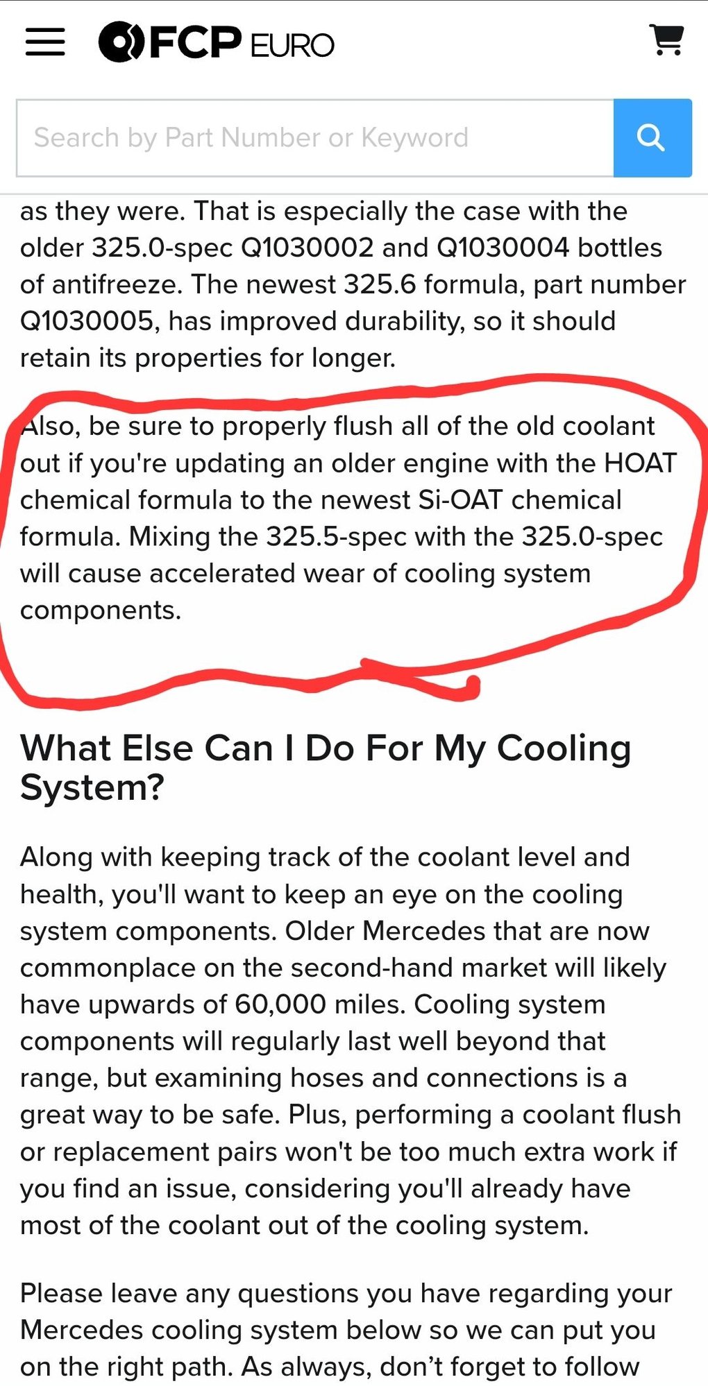

Looks like you're starting to frustrate others about this as well.
All of the answers to your questions have been asked and answered in this very thread so I'm honestly not entirely sure what you're asking.
I will sum it up quickly anyway. MB says you can mix 325.0 (BLUE) with 325.5 (PINK) in an official document posted here --> https://mbworld.org/forums/c63-amg-w...ml#post8862946.
That however doesn't mean you should. If you are going to switch, I would recommend flushing your cooling system first.
Done, no more repeat questions.
