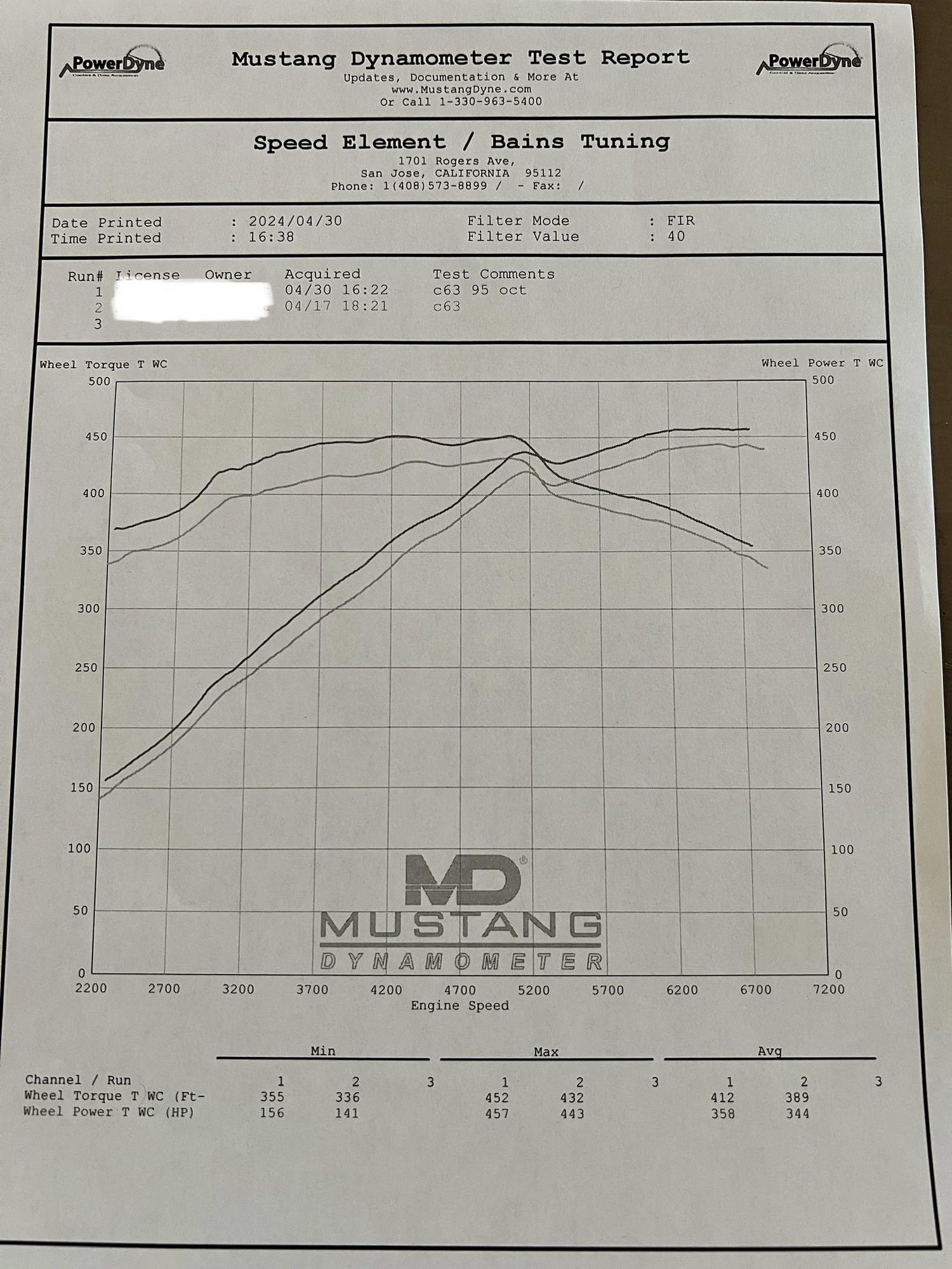

I got a chance to do another dyno run (same dyno and set up) but this time I ran ~95 octane and more importantly logged the entire session using VCM Scanner. The car has the same dip at ~5200 RPM but picked up about 12whp and 23 lb-ft due to the higher octane gas and the ECU running more timing for a new peak of 457 whp and 452 lb-ft. The logs don't appear to show anything anomalous, no alarming amount of knock or anything directly related to the car pulling timing within that RPM range which could explain this dip so I feel the most likely explanation is that this is just the nature of the tune that Weistec provided (at least to me) with their W2 tune.
The dyno graph can be seen below with the older run overlaid on top

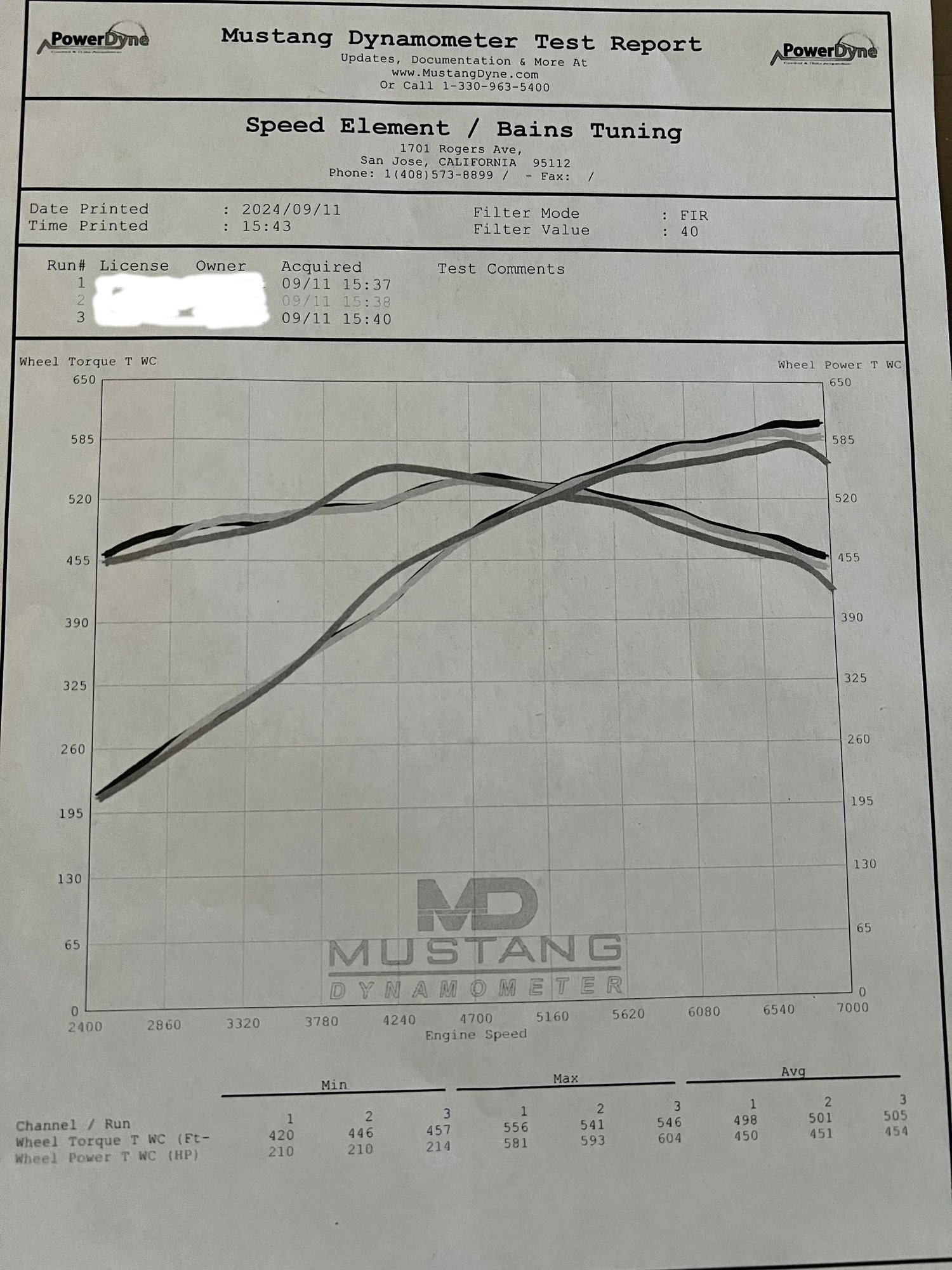

Post supercharger dyno run is done! The c63 managed to put down 604whp and 546tq using the same dyno as the initial pre-SC base run and same ~95 octane fuel. (And for anyone that's interested I also included an HPTuners log capture of the runs below)

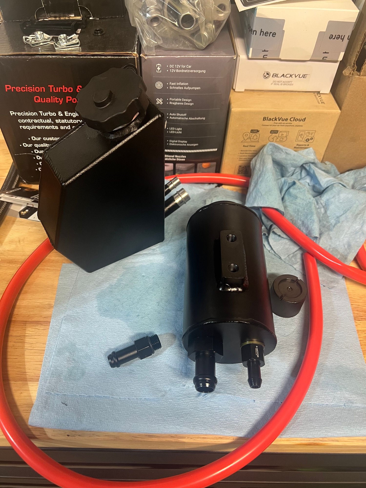

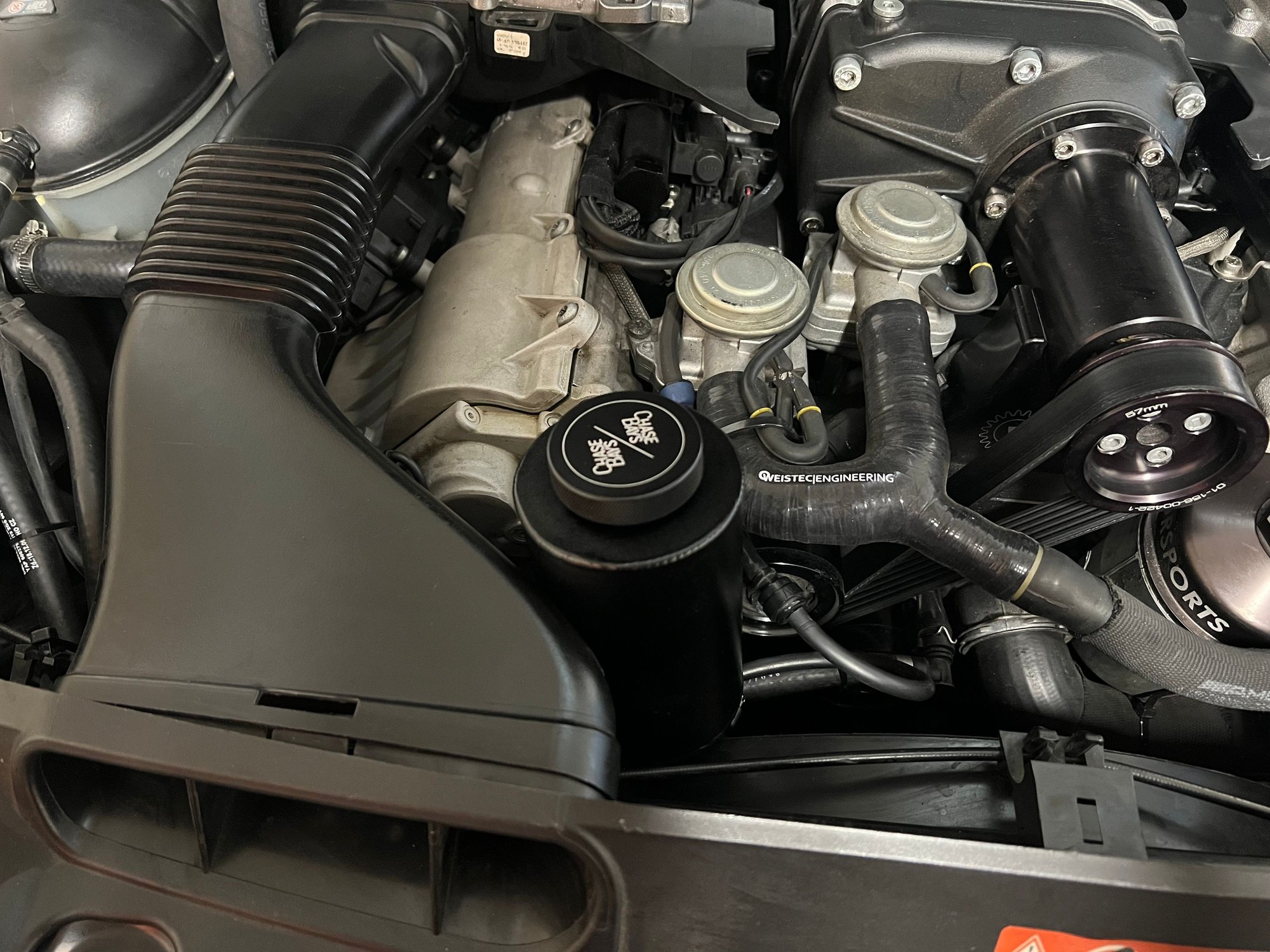

I was able to fix the power steering whine but had to go with a different power steering reservoir; I think the main problem was that the Weistec one is not baffled and that causes the fluid to aerate.
I went with triple baffled one from Chase Bays, (OE style push fittings and the "type 5" bracket) mainly due to size and highest likelihood of getting everything to fit. I did have to make a few modifications to the reservoir, one was to replace the screw type return line fitting with a smaller diameter one, otherwise the Weistec hose won't fit (but you could always run a larger diameter hose and cut about 1/2 of the "type 5" bracket such that it would clear one of the idler pulleys (since I went with the same placement location as the Weistec reservoir.)
Fitment is pretty tight as the new reservoir comes very close (basically touches) the insulation on the hood when fully closed (but it does allow the hood to fully and securely close)
Final installation
Final installation
An in-line filter that Im running on the return line
An in-line filter that I'm running on the return line
Chase Bays reservoir with smaller return line fitting
